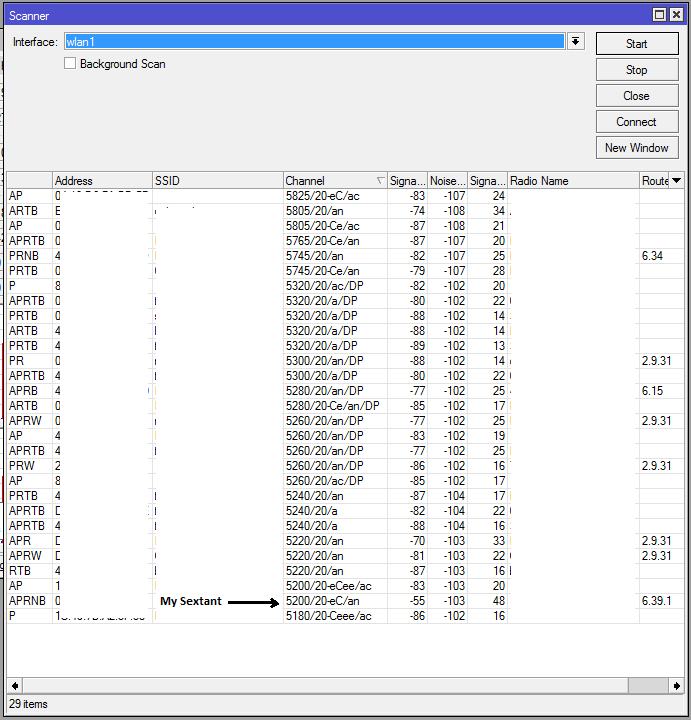

I actually use a bridge with two Mikrotik QRT for extend my LAN at 800mt and a bridge with two Sextant for my work office. at 500mt
With QRT i use 80Mhz channel and i’ve a good throughput… In this radio i use 4 VLAN, actually one for trasfer H264 HD video signal with HDBit module at 22Mbps, one for another HDBit ( in future), one for LAN and one for Guest network.
This is the scan with QRT, but is in another direction angle of the “Fiber Optic” transfer.

Have yet to find that IRL on any cities, you’re really lucky! how much does that QRT AC at 80MHz pass?
To do an spectral analisys, (Routerboard radio should be N, like in the sextants, or QRT N), open a new terminal and issue
/interface wireless spectral-history range=5ghz 0
Post a screenshot…

I meant I never have found 80MHz contiguos spectrum yet on any city. You’re really lucky.
I asked what is the throughtput of those QRTs AC linked at 80MHz, have you measured it?.
You need a N device for spectral-history to work, setting an AC device to N mode won’t work, because the limitation is in the radio chipset itself.
In other words, QRT N will work, QRT AC won’t for spectral-history.
