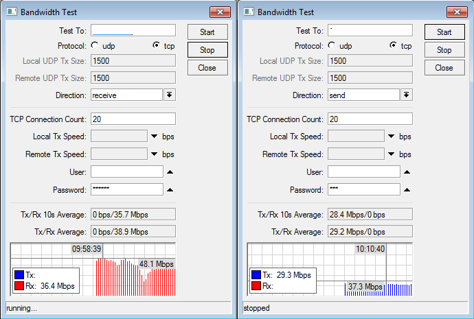

I have this 5km test link using Groove 5Hn on both side, there are not much interference from either side.

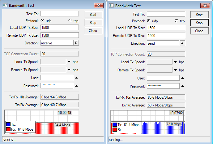

The most i’m getting out of this link were 55mbps TCP and 88Mbps UDP (one direction)
Comparing to previous setup using 5Ghz - Turbo mode, R52H i can get similar result of 55mbps TCP and 60Mbps UDP, nstreme (for some reason using nstreme is better than nv2).

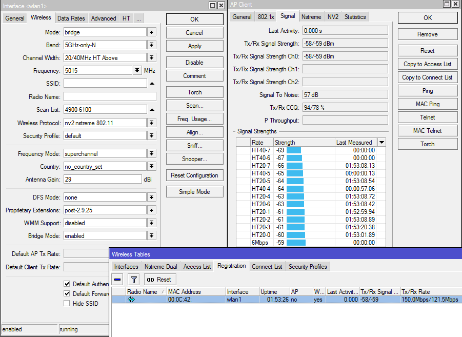

My question is, by looking at the parameter & connection what is the expected throughput (please look at the image attached)? Seems to me it’s good enough to achieve max result as advertised (125Mbps Aggregate Throughput), but i’m no where near it.
CCQ TX is almost 100% all the time while RX varies from 80% to 58%.
Any suggestion or advice?
Try using advanced rate-selection for data-rates and make sure you are running v5.6
Also what setup you have: you use WDS or regular routing?

Back with test results:
Scheme 1: PC to RB1100 (Distance 5km but reported as 7km by Groove)
PC-> GROOVE-AP -->><< — GROOVE-ST ← RB1100
TCP:
RX: 67Mbps
TX: 34Mbps
UDP:
RX: 95.8Mbps
TX: 37Mbps
Groove CPU < 20%
RB1100 CPU < 6%
Scheme 2: Ethernet Test Cable Length 40m
PC-> GROOVE-AP
TCP:
RX: 68Mbps
TX: 32Mbps
UDP:
RX: 98.8Mbps
TX: 38Mbps
Groove CPU = 100%

Overall results are improved after data rate set to advance, ticked all A/G and Basic A/G Rates
HT MCS all ticked as well.

So, possibly TCP limited (bottle-necked) by STP quality/length (?)
That’s lower than I’d expect from a direct ethernet connection. You using half-duplex for some reason?
The test were done one direction. Ethernet is set to 10/100mbps full duplex.
It’s definitely bottleneck-ed by the cable length (or even the quality of the RJ45). Tested again using factory made UTP at 1m long, direct ethernet, btest, I got 95-98.8Mbps both tcp and udp one direction, when trying both direction it drops to 70mbps Rx and 25mbps Tx (TCP).
