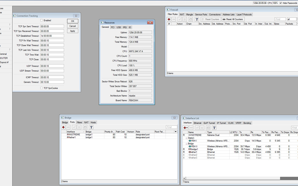

Why RB800? > I’m using a RB433AH for a link but at 40mbit the cpu is almost at 100%

You must have an interesting config to hit max CPU. I have many 433AHs deployed with 2 40mhz channels and get full rate at less than 15% cpu (full rate being 65+mbps of tcp traffic and 75+mbps of udp). With and without dual nstreme.
:frowning:
