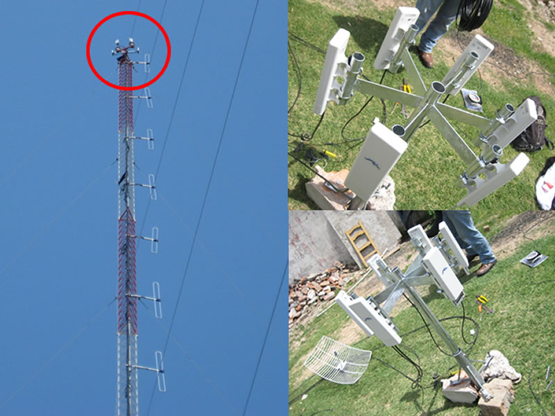

I have equipment colocated with a 50kW FM transmitter with absolutely no problems at all. FM antenna is 398ft, I have 2.4GHz and 5.8GHz equipment at 200ft. Absolutely no RF problems and it’s been deployed for 3+ years.
Just to share my exprience, I have used an FM Tower (600W RF) without any problems, I done several test with the fm on and off and no diference between cases.
Regards.
2,4GHz or 5GHz?
I like your antenna mount :slight_smile:
