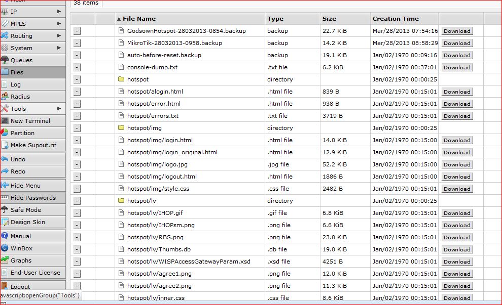

I’m new to RB/RouterOS, and so far an awesome production, to my issue: I’m attempting to setup a hotspot on a RB2011UAS-2HnD, by means of the hotspot wizard and the wizard goes through it’s normal process, however there are hotspot directories, but no html files including “login.html”, here is a pic of my File List:
Now I’ve tried clicking Reset HTML with no success, so I understanding this is a release candidate, so, it’s possible this functionality is broken. So, 2 questions:

you can manually create thos files or you can download it from other running Baord

Just downgrade to an older version, activate the hotspot and the files will be created. After it, you can upgrade again.
