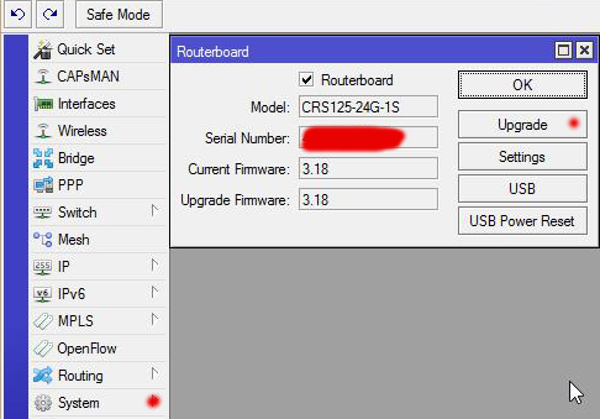

Have you upgrade the bios?
Go to “system” “routerboard”.
