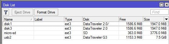

RB433UAH
6.23 (2014-Dec-03 14:50) one disk
6.23 (2014-Dec-04 14:46) dual disk :smiley: bonus?
It will be fixed in Winbox, but from now on such preset has to be added first.

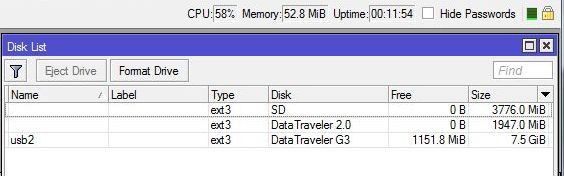

uptime 11 min crash :confused:
downgrade 6.23 (2014-Dec-03 14:50) crash :frowning: before updating to 6.23 (2014-Dec-04 14:46) works !
Ah-h-h, 6to4 tunnel’s routes to he.net work again :slight_smile: And again - it’s not in changelog =)
continuation
downgrade 6.19
upgrade 6.23 (2014-Dec-03 14:50)
winbox delete fake disk (disk1,disk3) ; rename disk4 > disk1; proxy disable, enable
reboot
6.23 (2014-Dec-04 14:46) bad build
cosmetic ..
