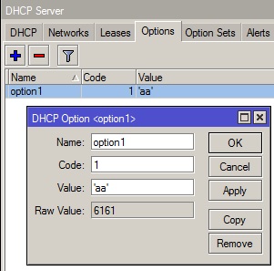

“Bug” is in the manual: http://wiki.mikrotik.com/wiki/Manual:IP/DHCP_Server#DHCP_Options
There should be an information that:
  1. using console to input string value, BOTH quotation marks should be used ( ’ and " ):
add name=Name code=10 value= "'Test'"
  1. using Winbox, only single quote should be used:

Right, thread is about 6.3. I am using 6.4.
