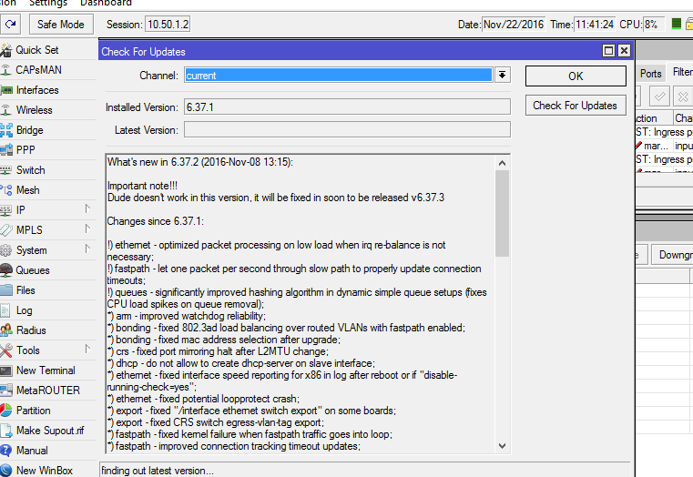

Just now we’d wanted to re-use an old SXT for a new client we found the upgrade showed 6.37.2 as the latest ‘current’ but no change log apart from the warning that Dude is not functioning in this (which?) version anymore!
So this IS very confusing and makes me wonder what the issue is and in which version did this came up?
