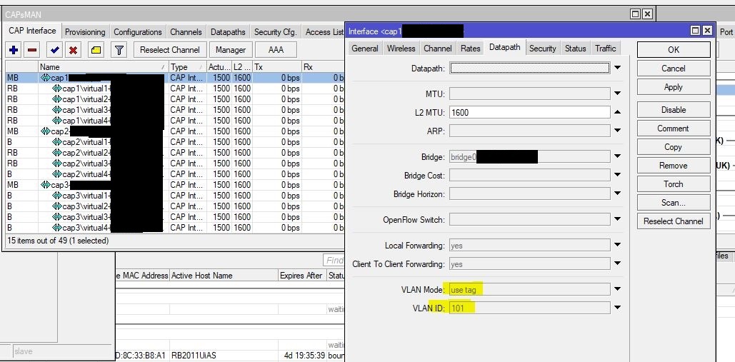

Right now I’m using 3 MikroTik’s, which are connected together. Two of them are working as APs, and one is CAPsMAN. In total there is 4 networks,
and every network has it’s own Virtual Access Point in CAPsMAN. They are connected to the same bridge - bridge0, then there is VLAN tag on every one of them in Datapaths.
I’m using one bridge to connect everything - Ethernets + CAPs.

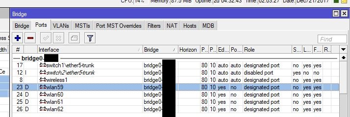

I tried to use new VLAN Filtering in bridges, but once I set it up and turn it on, every Ethernet port is working fine, but I’m losing connection on WiFi due to VLAN tag in CAPsMAN
which is impossible to filter in new VLAN Filtering in Bridge(pic #5) because they are dynamic.
Is there any way to do it?

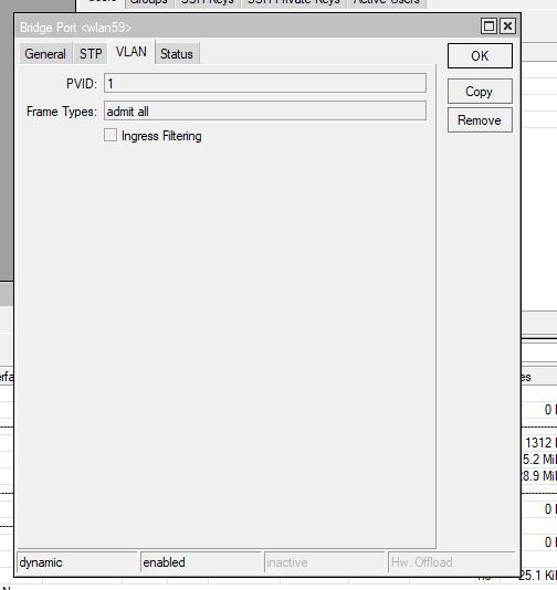

I am experiencing the very same thing. CAPsMAN’s VLAN setting seem to be useeless at this point as PVID seems to be used instead. I have not been able to make this work.

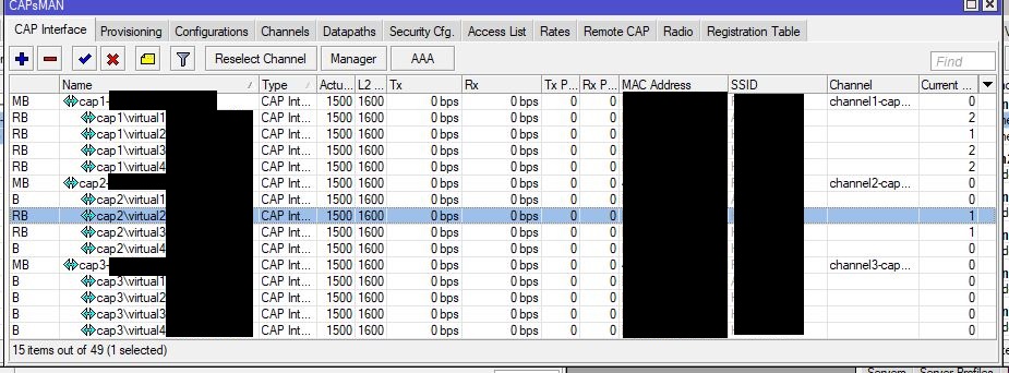

Guys, you have to use static virtual interfaces in caps settings. It’s not gonna solve all of your issues, but at least it will let it work.
