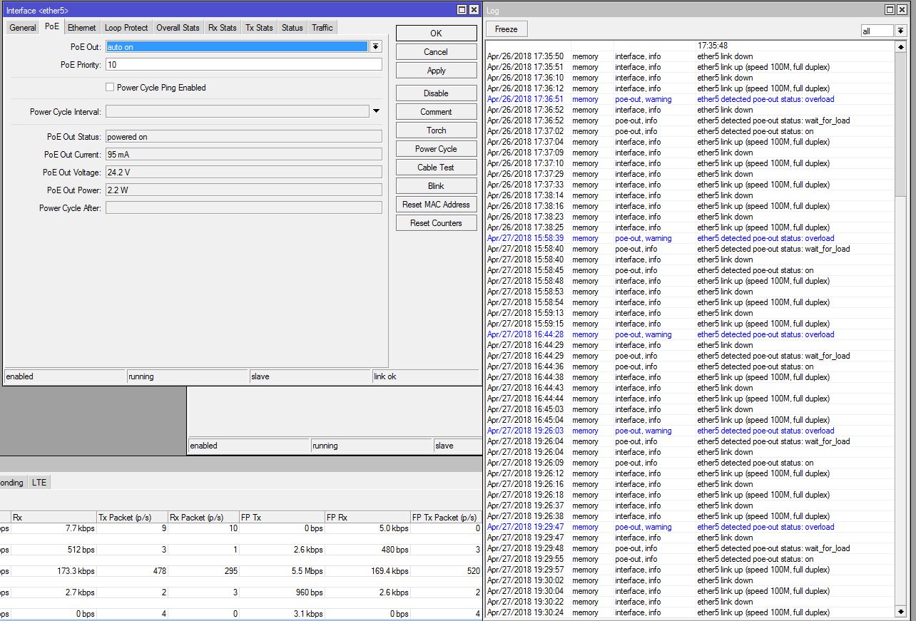

Attached is a screenshot of the log and the POE tab for the interface.

Is there other poe devices connected to your PowerBox? If total consumption reaches 2.4A (with 24V power supply) then poe-out port with lowest priority (in your case it is most likely ether5) will be powered down and overload event would be logged.
Try moving your nonostation to different poe-out port (ether2 has highest priority in default configuration) and check if problem moves with device.

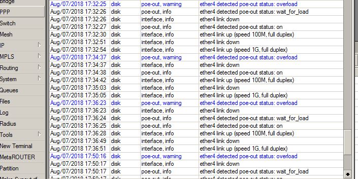

I have the same thing. The device is overloaded with 3 Ubiquiti Prism. With two is OK. :frowning: Ver.6.42.6
