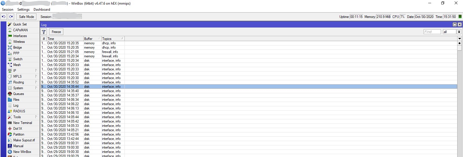

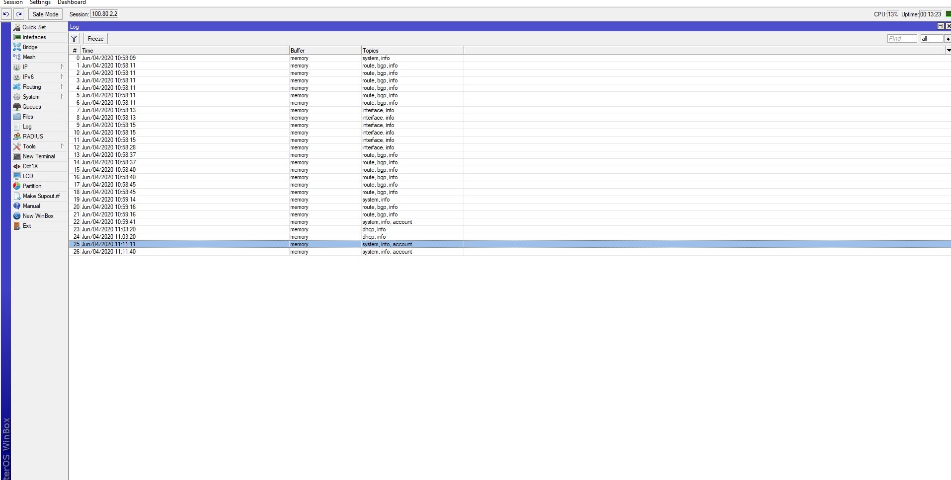

CCR 1009 with 6.45.9
it works flawlessy but this morning I am not able to see logs.
Winbox 3.24 x64
rebooted the router, I cannot see them.
If I enable the detailed mode, I can read them.
what is happening?

upgraded to the latest long-term and the problem is still there.

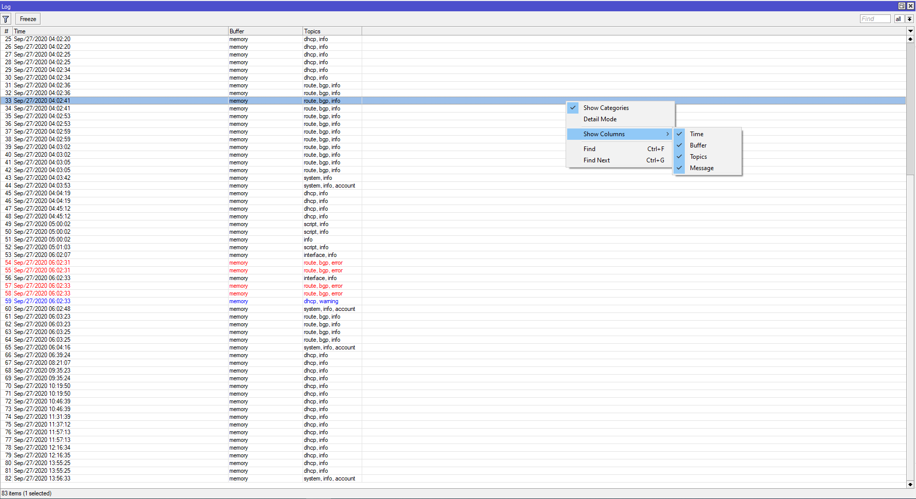

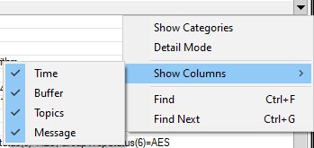

Is the message column removed ?
The window is correctly set.

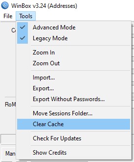

Clear winbox cache ?
Thank you for pointing out this feature.
The problem appears as before.
If I select a different IP of the same router, I can see the logs correctly.
