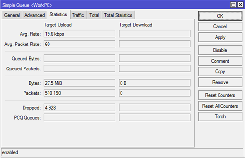

The device I am looking at is rule 2 (WorkPC). If I run a bandwidth test I achieve 2.7+ mbit D/L and 0.34 mbit u/l with the queue turning red for upload only. The image below shows a log of activity during the download (none).
Any pointers?
