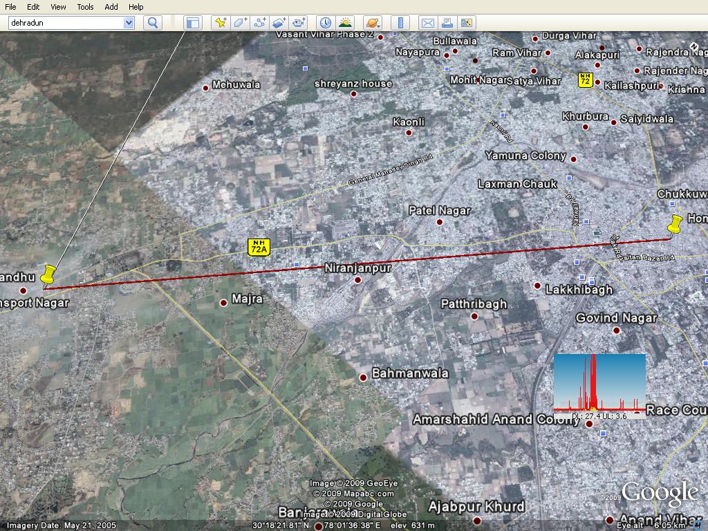

Facing a strange problem on a 6 Km link.
Site 1:
MT= 411AH, Mini PCI= Compex WLM54AGP6A(26 dBm card), Antenna type: 5.8 GHz Solid Dish
Co-ordinates:
N= 30deg 19’21.40"
E= 78deg 02’13.31"
Elevation=661 m
Antenna Height=24m
Bridge Protocol=stp
dish.
Site 2:
MT= 411, Mini PCI = Compex WLM54AGP6B(23 dBm card), Antenna Type: 5.8 GHz Solid Dish
Co-ordinates:
N= 30deg 16’56.72"
E= 77deg 59’30.87"
Elevation=602 m
Antenna Height=24m
Bridge Protocol=stp :frowning:

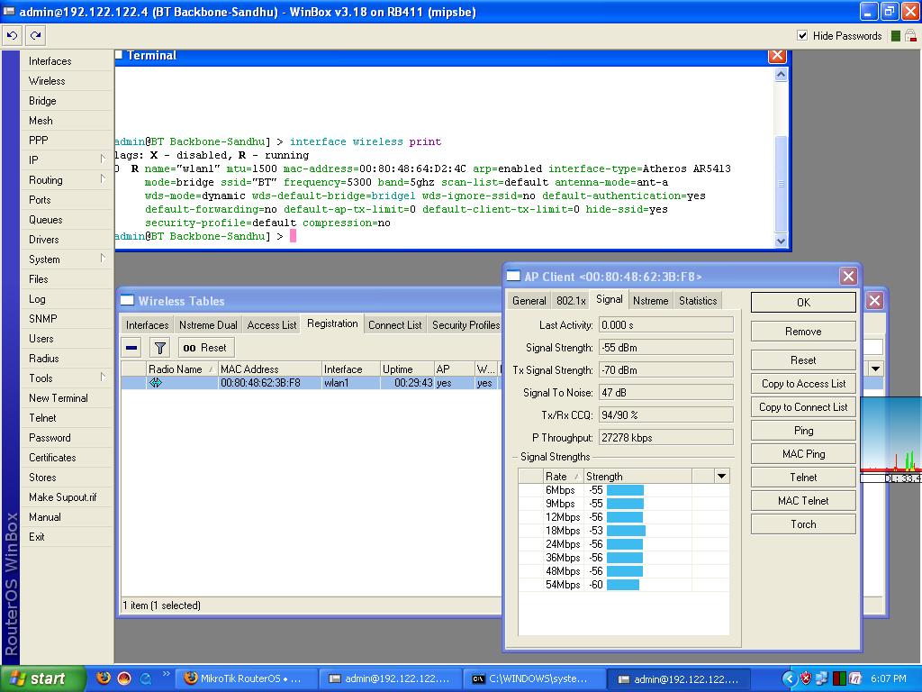

Worked alot to get the signals equalize between -65/-62 dBm but failed, LOS is very clear.
The card rates are set to 18 dBm. Using LMR 400 pigtail(1 metr.) tried changing MT also.
  1. when I increase the card rates, the performance drops.
  2. there is not enough throughput.
  3. Bandwidth test shows less than 2 Mbps both ways.
  4. tried changing antenna feeds/pigtails also, no joys.
  5. Worked on all frequencies (5300-5825) but did not work.
  6. Worked with Bridge protocol disabled also.
How can I improve performance
I am not getting the enough bandwidth to run clients.
Please help :frowning:

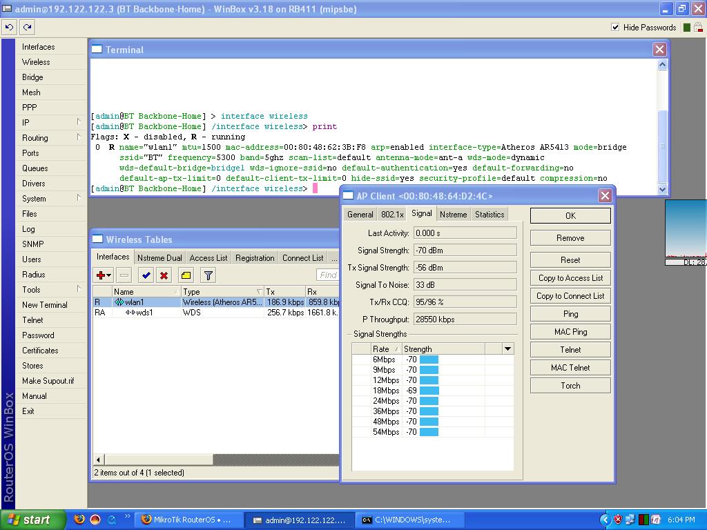

I am new to this also but i think the receiving side, mode should be =station
You appear to have mode=bridge at both sides of the link ?
n21roadie
Its also running in wds mode.

The client must be in station mode. I thnik this set up is much easier than the other issues that yoy have involving the TP-Link’s, since in this application you Mikrotik in both ends.
There is a perfect example on the wiki that you can use as model for your setup.

What bothers me most is the difference in the signal levels on both sides.

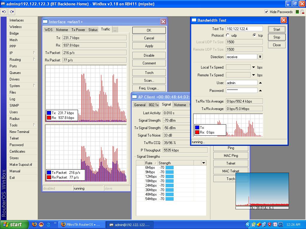

Apart from it when I test bandwidth one ways(receive only) on both MTs, It starts with 17Mbps goes to 20-21 Mbps just for a second or two and then falls back to 4-5Mbps average(lowest levels even goes to some 500-600 Kbps) for some seconds.
While in bandwith test: THE TX/RX CCQ FALLS DRASTICALLY to 15-25% levels from 90-95% levels without Bandwidth test.
Is that a usual phenomenon when u put load on MT?

one card may be damaged, I see a -70 and a -56, something is wrong. I can’t see Nstreme if is enable or not…must be enabled.
