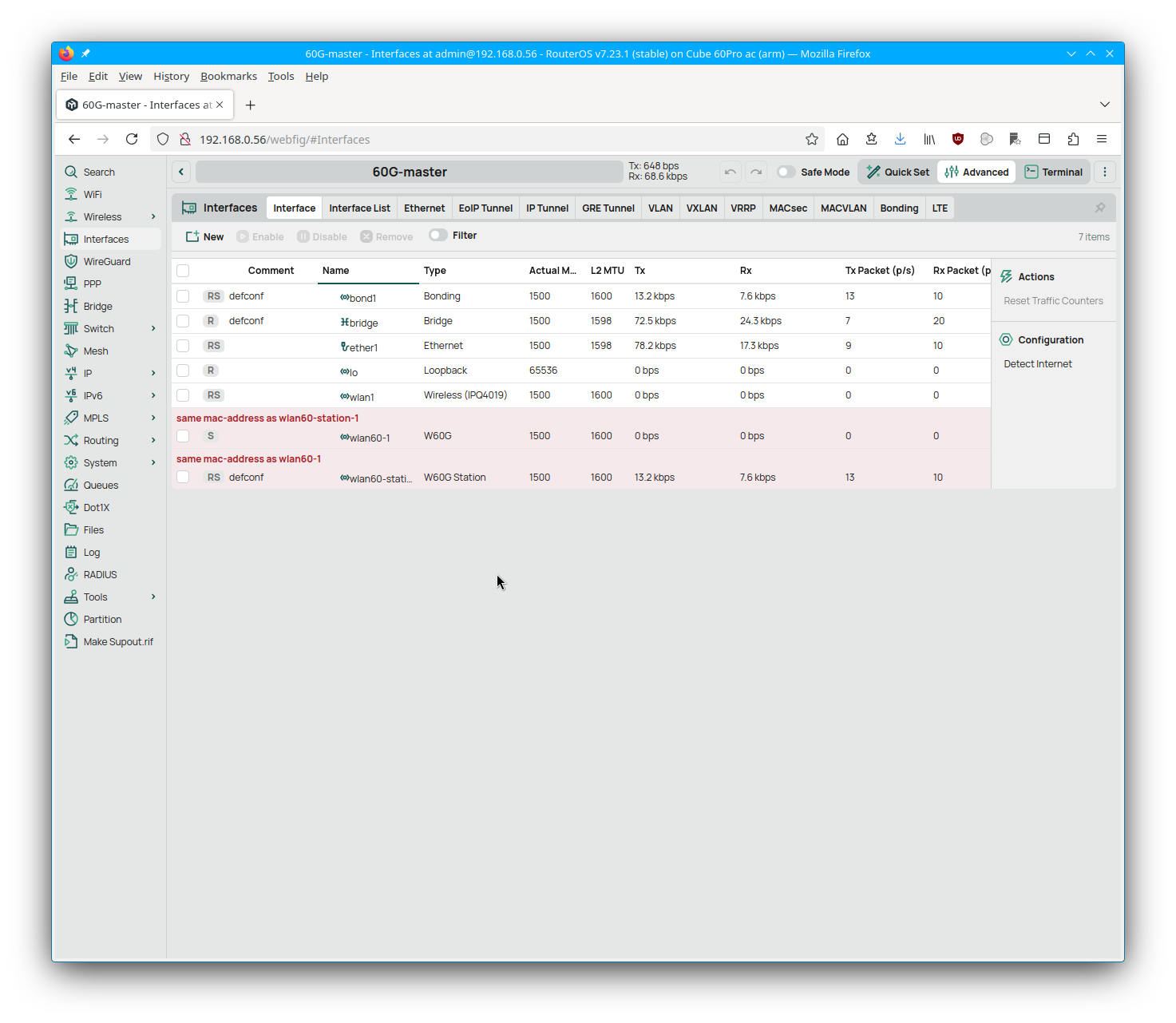

60G units report a warning after update to router 7.2.3.1
After update to 7.2.3.1 this warning comes in the interface overview
Br Knud
just read what's written in red, and fix whatever the writing is complaining about...
for example,
if wlan60-1 have MAC 30:AB:6A:DE:AD:BF
wlan60-station-1 should have MAC 32:AB:6A:DE:AD:BF (add 2 to the first hex number)
MikroTik did not warn about this serious configuration error in previous versions.
I need to check if what's written is correct...
I noticed an inconsistency in RouterOS.
It is correct that the 2 MAC addr are the same but I have not touch anything at any time in respect to MAC's
Before ver 7.3.2.1 it did not complain and expect the MAC's where also the same
Knud
In the control they added, they had to exclude this case...
Does that mean there will be a update in the future ?
Everything works ok
Knud
I do not know, for sure is a wrong error displayed
Ok..I will just wait and see what happend
