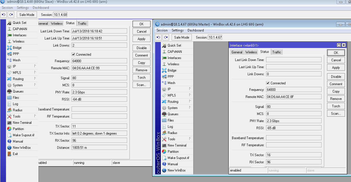

we have installed our first LHG 60 ghz link and we are very surprised: 1809.48m and we get 2.3Gbps..WOW
And -65 RSSI… now wait for a little rain and see what happen.
60Ghz is right in the oxygen absorption band. Which mean that the signal will drop very fast with distance. 2.5Km is very long range for 60Ghz. That’s one of the drawback of 60Ghz and one of the the benefit: There is nearly no interferences between links on the same channel and in the same area as their signals are be absorbed.
There is also a significant signal lose when raining especially over a few hundred meters. Less than with 24Ghz but still very pretty big. At 1Km+, you can easely lose 10 to 20 dbm during heavy rain and it only get worse with longer distances so if you don’t have plenty of margin to begin with…

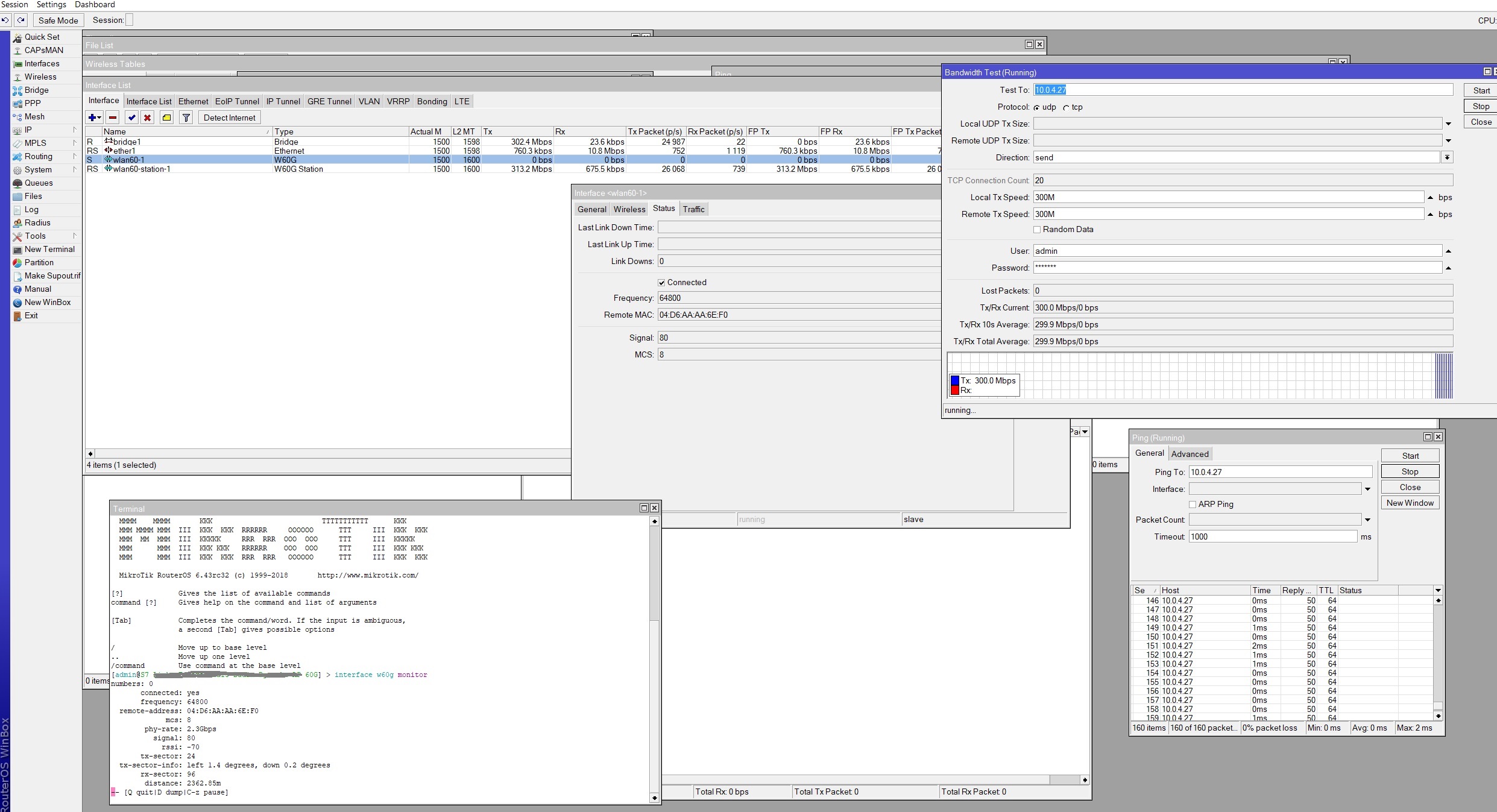

Now rain and one side not adjust work ok

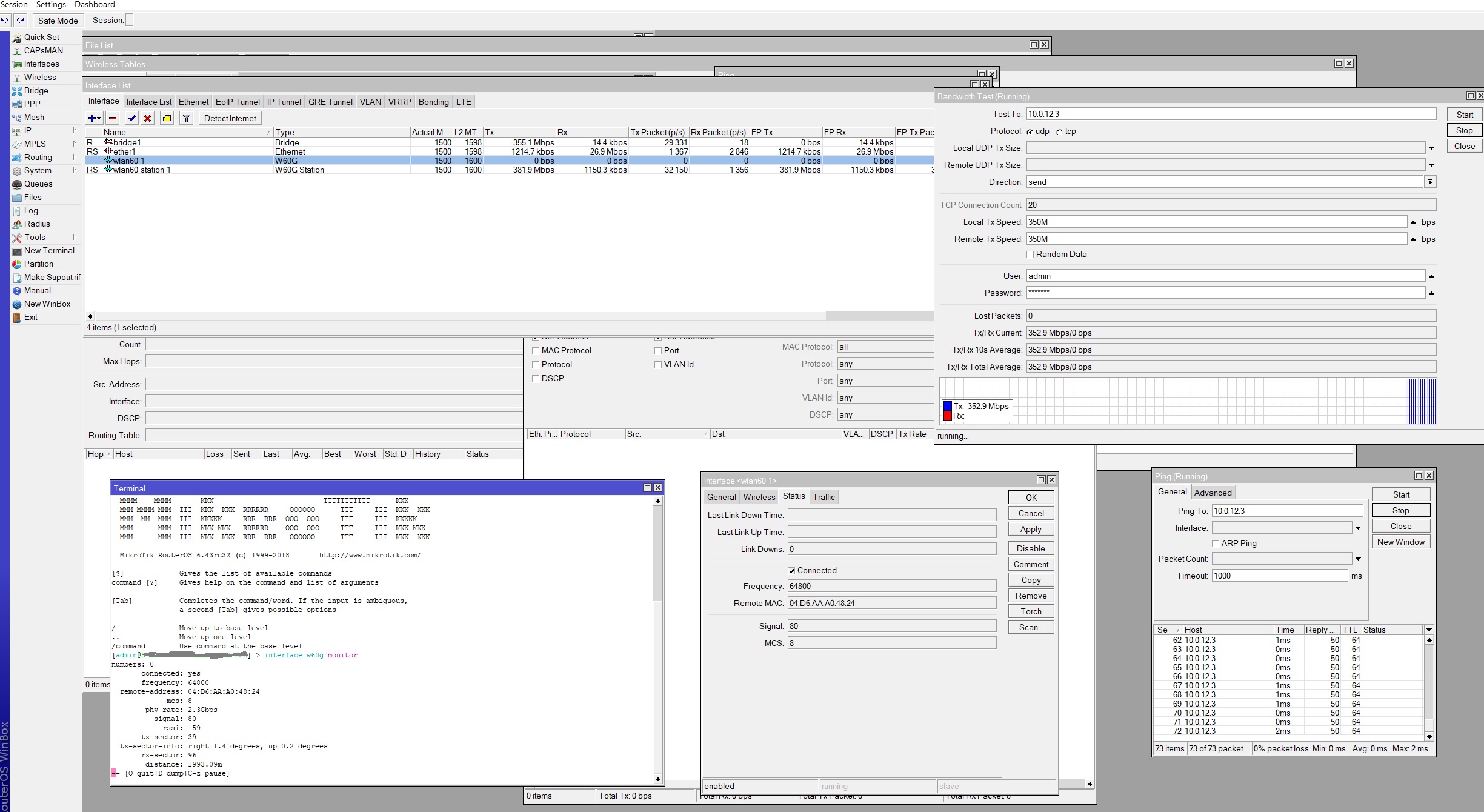

right now rain , normal rain has no effect only very very hard rain was link down 2min
MulderSk are you using a couple of “normal” LHG60?
yes
