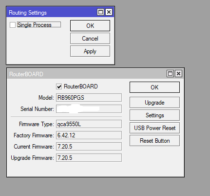

Thanks, i looked but there was no options under routing settings in winbox, just a tick box for single process, same in terminal, i just upgraded software and firmware to 7.20.6 but still the same.
Am i looking in the wrong place?.

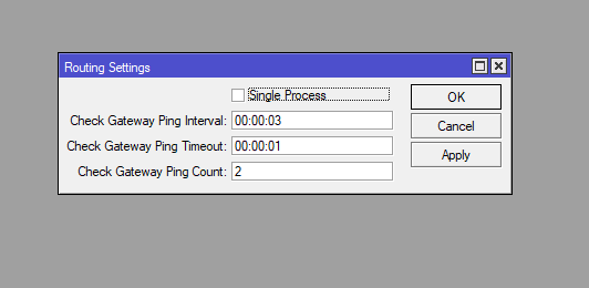

It is only in the 7.21 version which is now in testing. (7.21rc1 is the most recent)
Thanks, yes i see now, just upgraded and tested, seems to work really well, just one timeout to the lo ip address when i disable the 60GHz rf interface.
