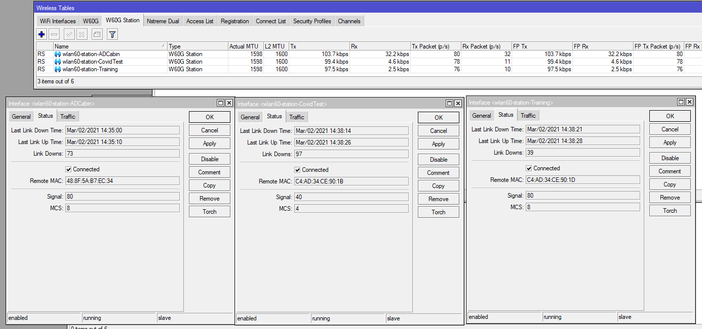

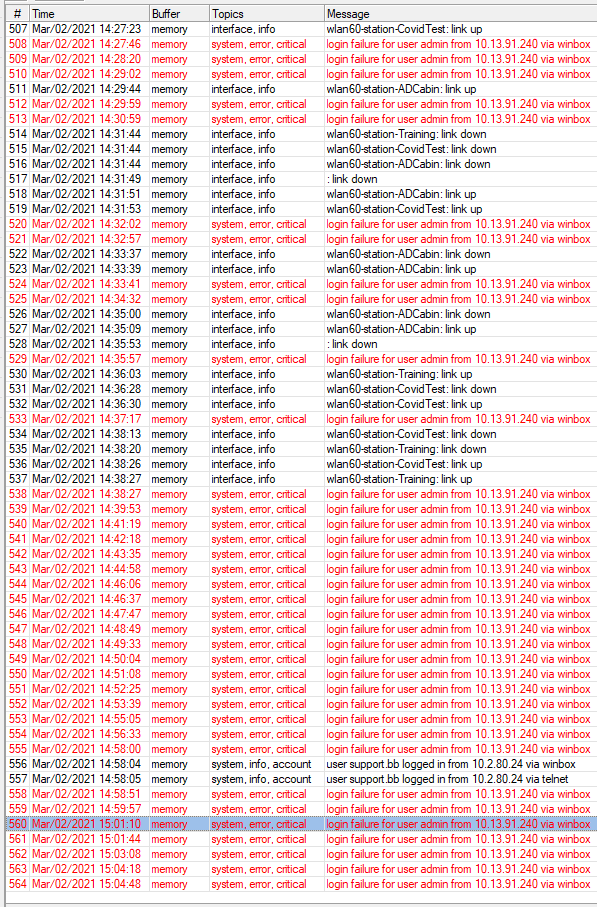

From what I can tell the links are dropping and reconnecting regularly as can be seen in the log.. but as soon as you login to the unit (ignore the dude attempts). The drops stop.

Any thought’s?? We do have other 60G links in the area, all are not in LOS and have buildings in the way. The difference is that are all PTP’s not PTMP.

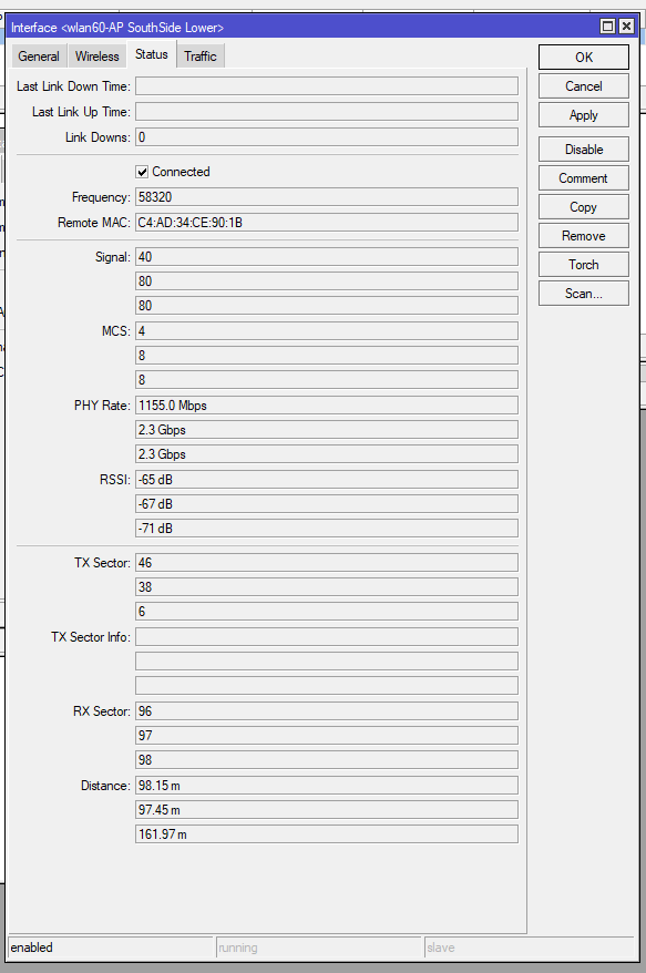

Signal level is not great, might be better choosing a higher frequency channel.

Latest Version 6.48.1 - Stable, I’ve changed the frequency now and it seems better.. It was just the strange thing of when logged into the AP it stopped the link drops.
