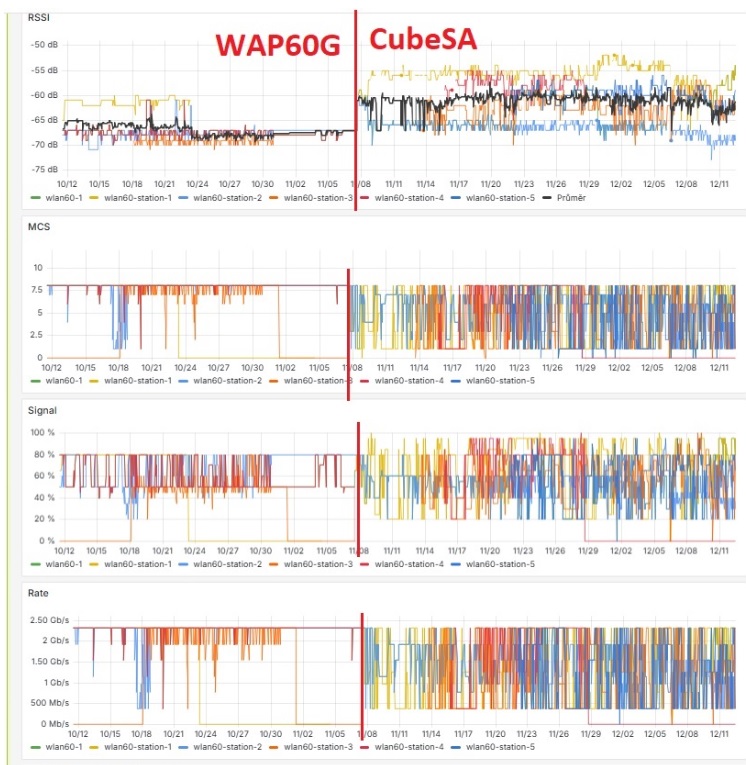

I reported it to support. Next problem is stability with CubeSA - see image.
With WAP60G is speed and MCS good
