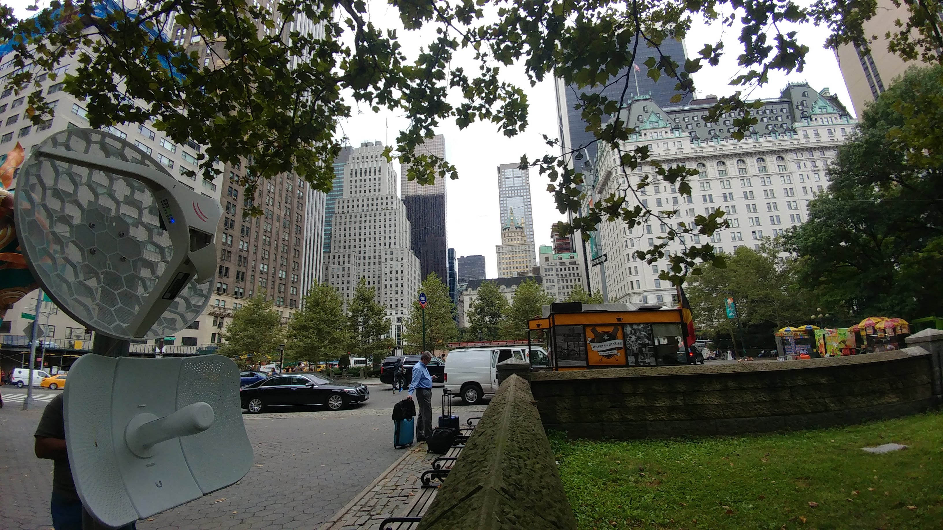

Just today while installing a lhg60g link today in Central Park, I was wondering if the Mikrotik team would ever shed some insight on the alignment procedure. The up/down/left/right lights are like chasing a cat in a hat. The signal % means nothing if compared to RSSI. Yet, the strongest RSSI is usually slightly off from a visual best alignment.
The product does work great! But the alignment is like shooting jellyfish in a barrel. It would be nice to have some insight from the guys who designed the product. We are putting in 2-3 links/week, I hope they help soon

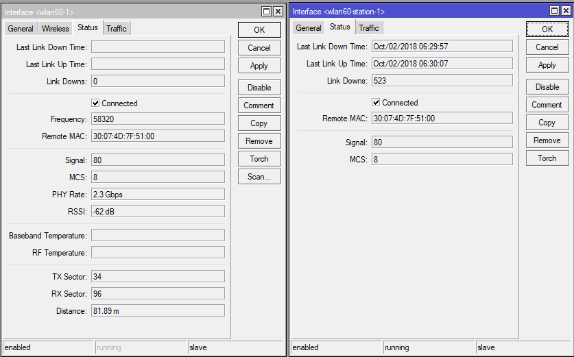

Here is a common example of our links. The amount of link downs is numerous, we are @ 81.89m in distance and -62dB. I can;t tell if we are way out of alignment and we are @ center. We have tried fine tuning these but cannot seem to get better than -61/-62 or so.
This particular link is line of site with 0 obstructions.
