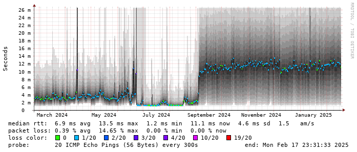

I have some trouble with CubeSA Pro (just the AP, not the Cube Pro stations) in a PtMP setup. It seems to introduce a lot of latency and jitter, even at low traffic, and I have reproduced it in a lab setup with the second CubeSA Pro as well, so it’s not distance or interference (or single bad hardware - though it could be a bad whole batch of the hardware as both were from the same shipment, one of the first ones when introduced, devices were not yet available in PL so I ordered them from CZ to be the first one to test them). It’s just that the good old wAP60G-AP (the one with license level 4, be careful when buying as there are also level 3 station-only devices without the “-A” in product code) work better as long as there is more than one stations connected, latency is lower and more consistent.
That’s a pity, as my main reason why I was waiting for the new “ay” devices (other than >8 stations and Terragraph, also never happened) was channel 5 support for longer range - the old APs only support channels 1-4. On the positive side - only the new AP is broken, the new CubePro stations seem to work well connected to the old wAP60G-AP, so they are good replacements for the discontinued Cube-60ad.
The jitter and latency issue with the CubeSA Pro is the same with both RouterOS 6.49.3 (in the lab, version the device had from the factory) and 7.15.3 (in the field, upgraded in the hope the issue would be fixed but it is still not). All it takes to reproduce is connect 2 stations to the AP, even with no real traffic the jitter becomes a few more milliseconds on the new CubeSA Pro compared to the same test done with the old wAP60G-AP where latency increases significanly only under heavy traffic.
EDIT: added SmokePing graph, in the middle (Sep 2024) was the point when the old wAP60G-AP was replaced with the new CubeSA Pro, as the AP for 5 stations (earlier replaced one-by-one from the older Cube60 or LHG60).
#[SUP-179673]
