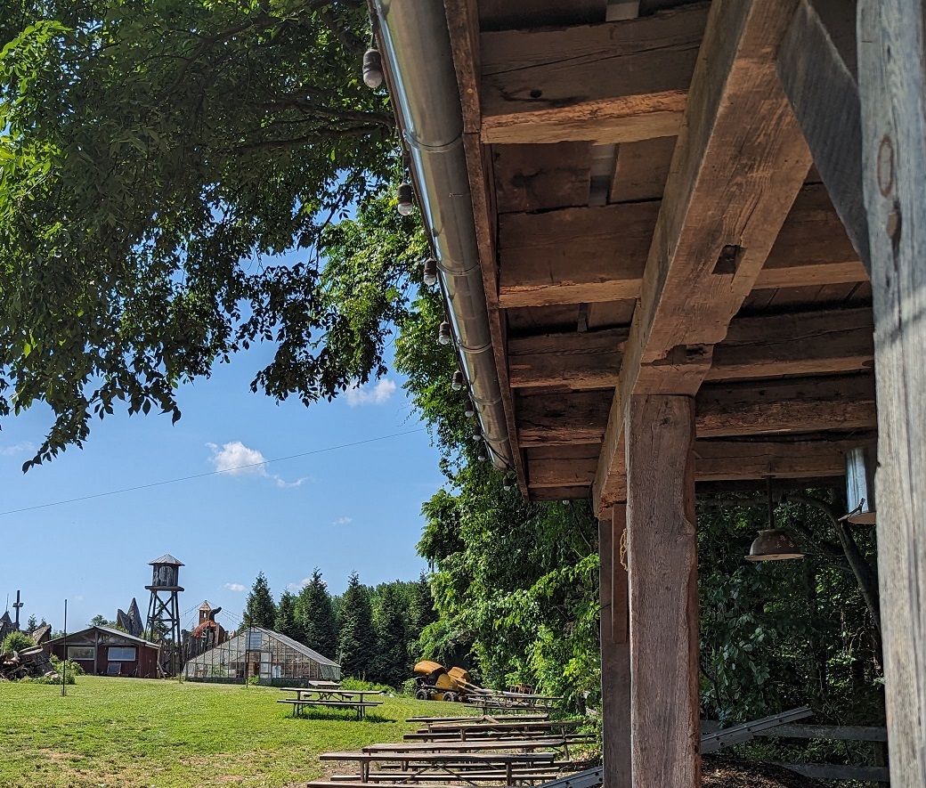

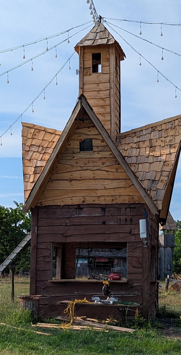

Needed to point to point link, the Kitchen to the Bell Tower at an outdoor event space.
wAP 60G AP near the top of the tower. Aimed around the Haunted Forest Jack-O-Lantern. Fed by A PowerBoxPro

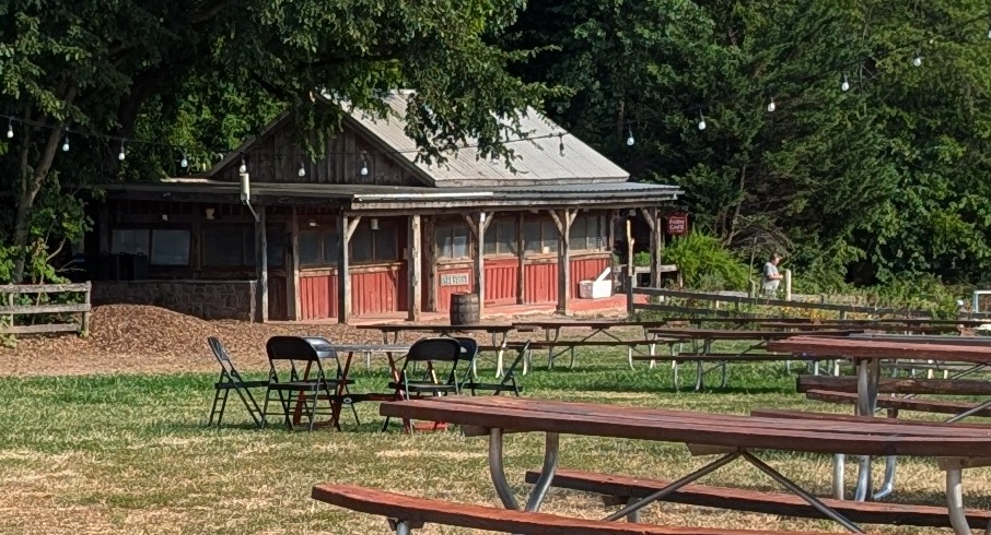

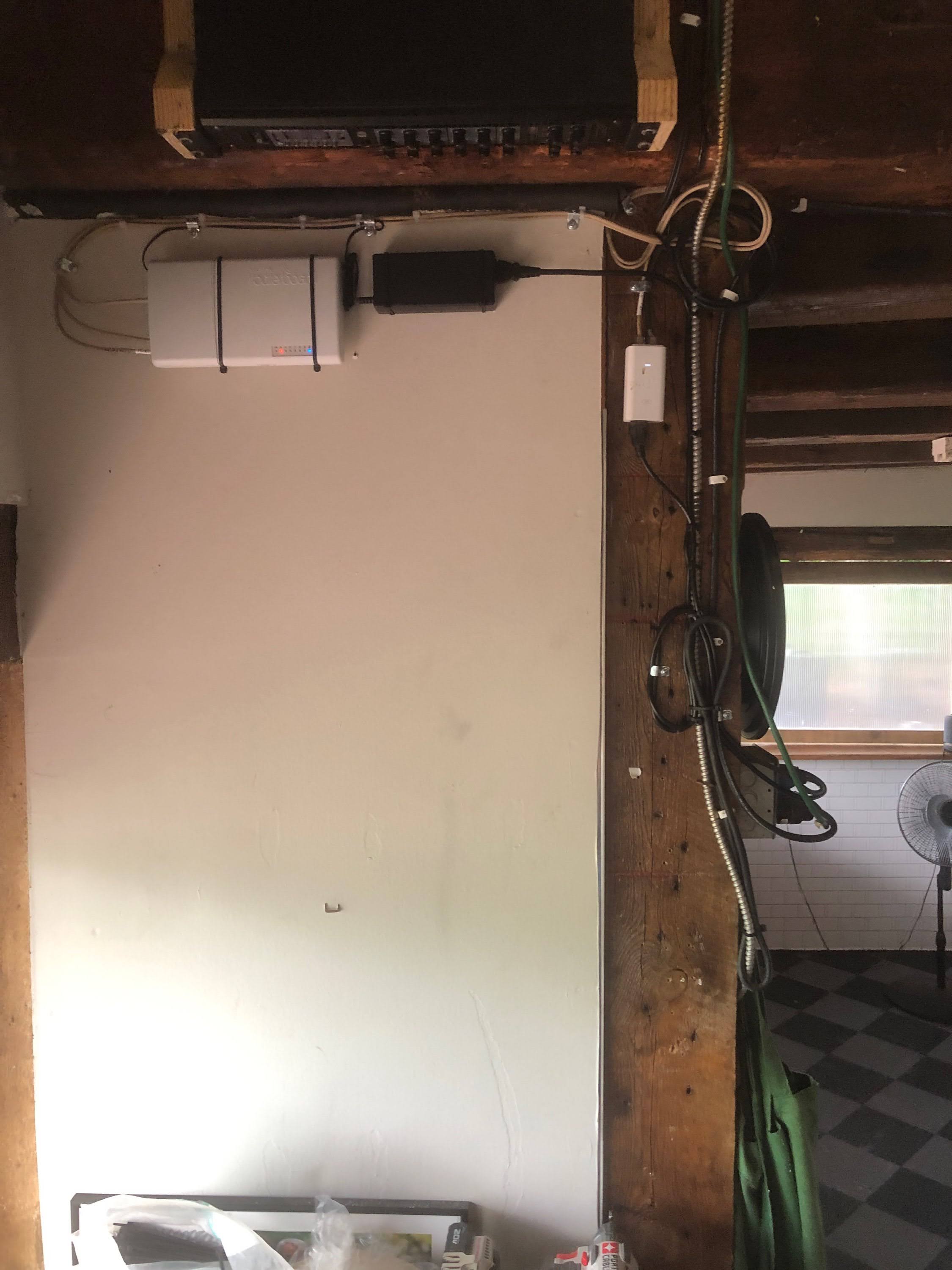

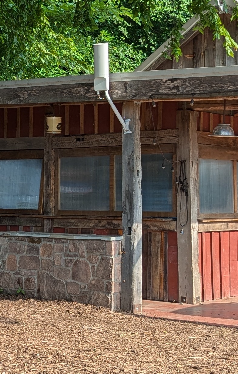

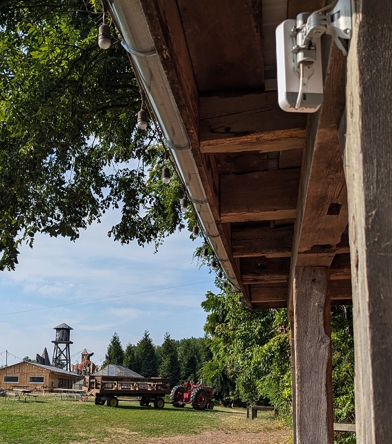

wAP 60G mounted on the ease and routed to a PowerPoxPro. Which feeds the XV2-2T mounted on the other side of the Kitchen.

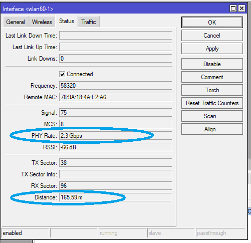

Distance between both unit is ~160 Meters. (Google Maps is pretty spot on.)
PHY 2.3G
Signal -66
Maxed out the 300Megs of the WAN with ease.

Follow up pics.
:clap: :clap: :clap:
Now paint the antennas black or the same color as the wood.
Sweet! Good proof of concept for any one here thinking of something similar. LIke the fact that the one at the ‘house’ is somewhat protected from the elements as well.
Reminder to me that the beam is fairly focused near each device and thus clearance is not a big issue as opposed to halfway between the two devices.

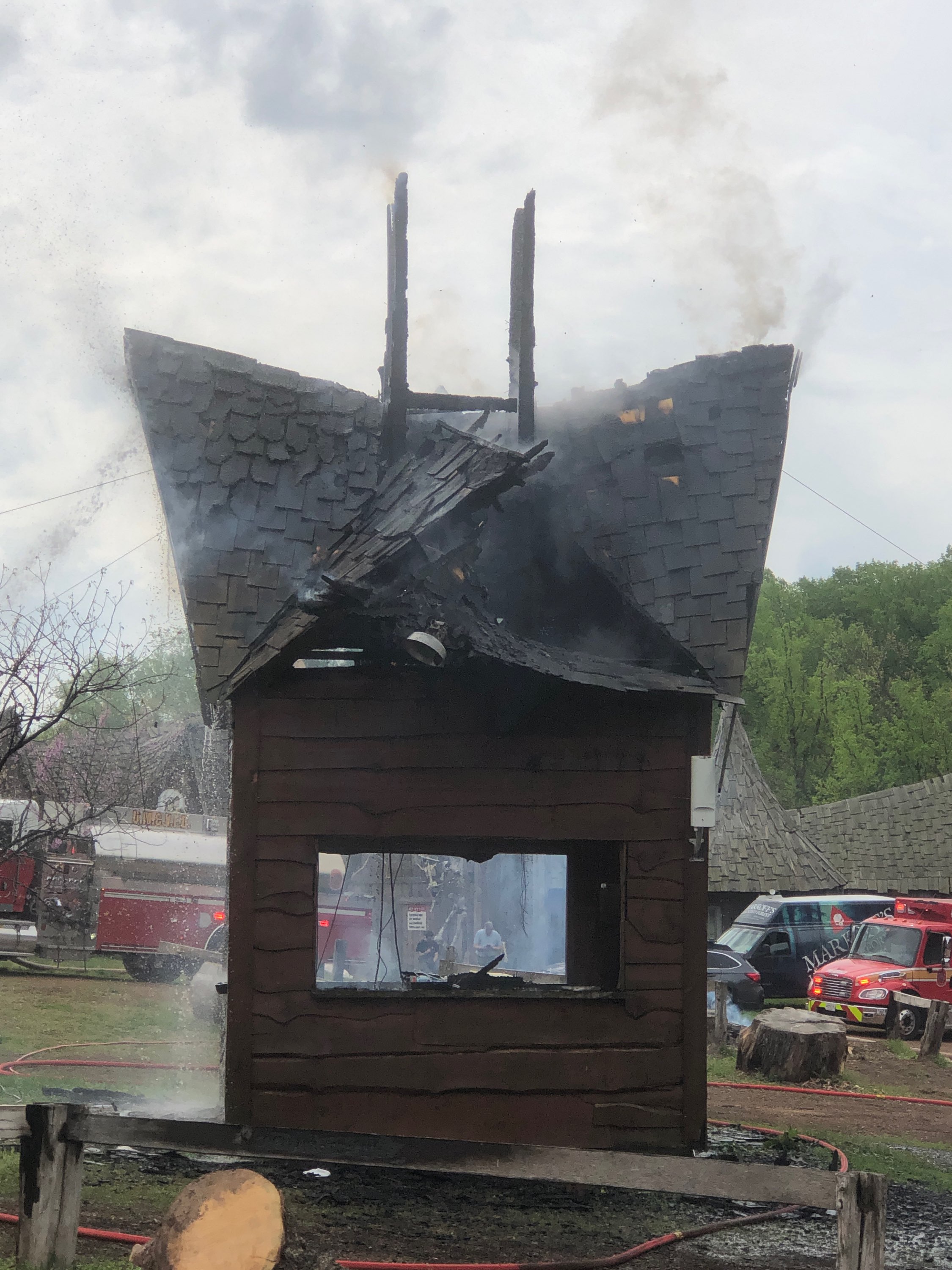

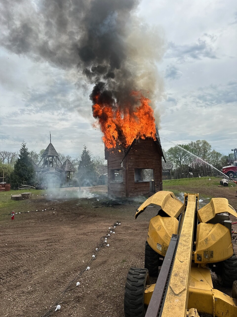

well they were covered in soot at one point.
Terrible news. It was a nice looking structure.
Why did it start burning? Did you find out?
