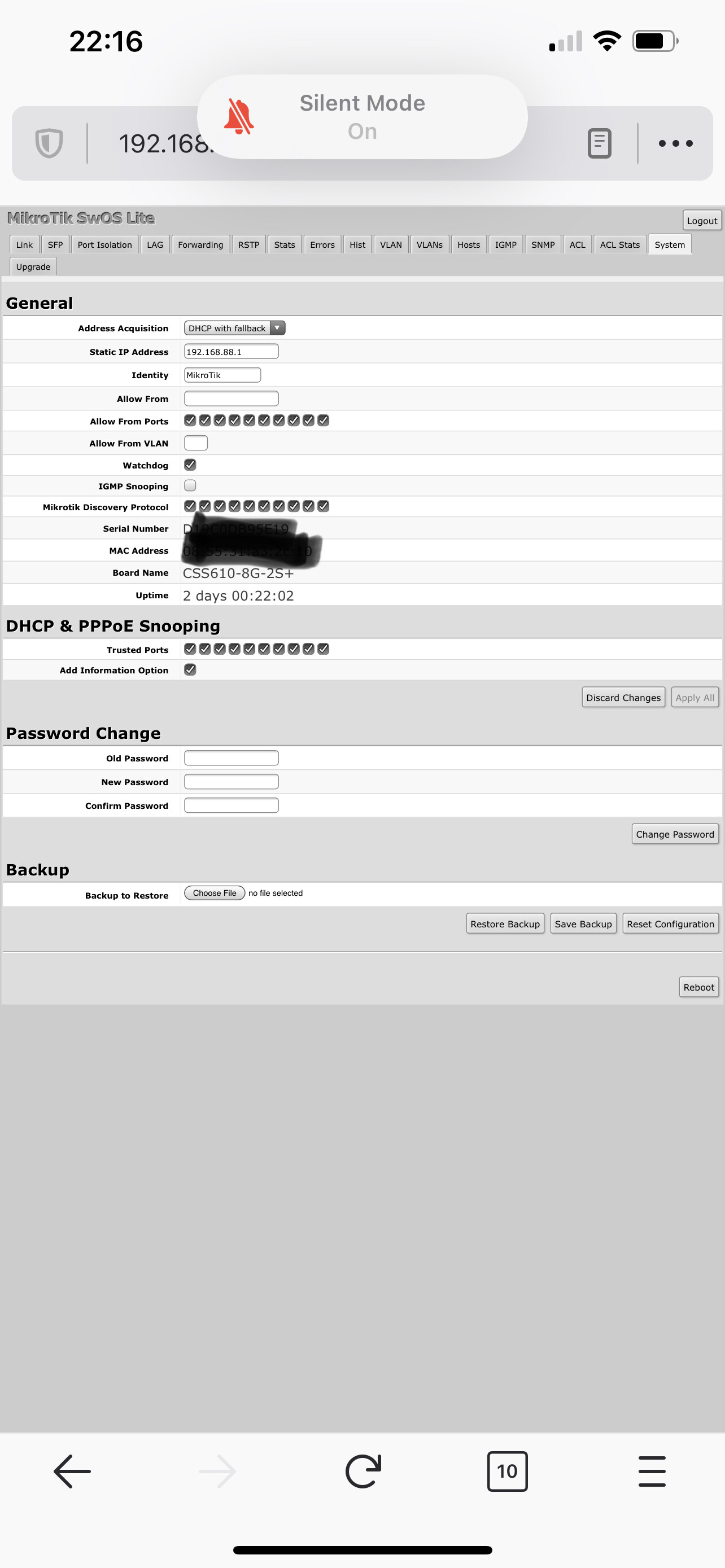

Hi everybody,
I just upgraded SwOS to 2.13, and reading the changelog from the switch itself, i read:
What’s new in v2.13:
*) CSS610: report temperature under System tab;
Is it only me or there’s no temperature in System tab?
In general this version looks really better, I am now able to connect to the console every time I try to (!) :).
On my Netpower 7r (also a CSS610), im getting the temp just fine. Its located in the system tab under the health section
Thank you, in my System tab there’s no temperature info.
No health/temp option in my case too.
Not just you. No Health section under System for me with 2.13.
In fact, the only reference to temperature on any tab is under the SFP tab, which are running a toasty 50C & 60C, with two S+RJ10s, though only one is active at 1G.
-MB
…same here…I think this is only with the outdoor Version of the CSS610 then?
It looks like it.
