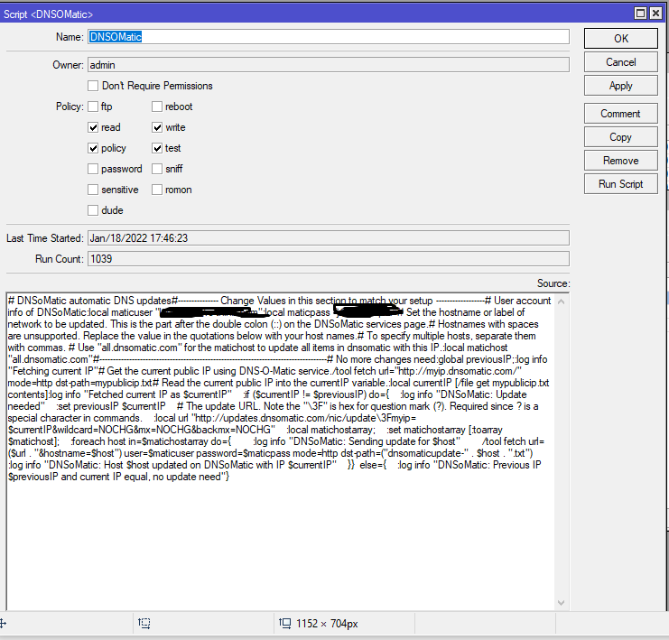

I just upgraded to 7.1.1 from 6.49.1 and the formatting is all gone in the scripts in winbox but it looks fine on a browser with webfig

Could you describe or show what the issue is?
this is what i see in winbox

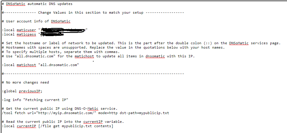

this is from a web browser
It’s most likely Unix line endings. Do /system/script/export and check if you see \r\n (Windows) or just \n (Unix).
thanks
i only see \n\
strange that webfig would handle it fine but not winbox (especially as winbox used to handle it fine before 7.1.1)
hopefully an easy fix for the Mikrotik team
WinBox saves with Windows line endings.
WebFig saves with Unix line ending.
Script editor in CLI (/system/script/edit source) also saves with Unix line ending (please mention this too when you write them).

I just tested pasting the script into winbox and it formats fine in both. However, when I take the same script from the same clipboard (so identical content) and paste it into webfig it loses all formatting in winbox (which makes me think winbox may indeed have the issue with Linux formatting)
I guess one answer is to write/paste your scripts in winbox? I don’t know what happens with command line
I wonder how they managed to not reproduce it, it’s clearly there:

\r\n when saved in WinBox, \n otherwise.
Well it’s pretty easy to reproduce with webfig when creating a new script on 7.1.1.
I have tried creating a simple script with 5 lines and while on webfig when writing and editing it looks fine, in winbox and on export it has line ending with \r\n.
