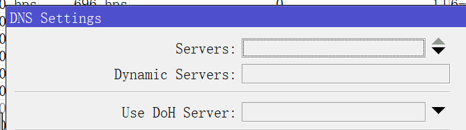

Yes, the unvalidated unique value is max concurrent queries, setting it to 0, DNS no longer responds…

I have many forward-to rule in dns-static.
it works on 7.9.2, but random lost happen on 7.10 stable.
Moreover, I have conducted tests and found that if no rules are configured in dns-static, it does not cause this issue.
It seems that the DNS resolver is crashing.

It’s really a random serious problem and I can’t catch any useful logs, so I think maybe the DNS server crashed before print logs

As a potential workaround block access to dns resolver from WAN port and do not flush dns cache on every ppp reconnect.
