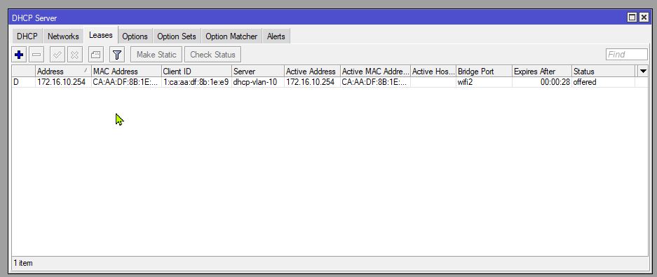

Hi
I am using a hAP ax² to run capsman and some cap ac’s using vlans, the ssid is showing up but when connecting the issue is the dhcp server is not binding the ip address, the status remains “offered” under leases, any help will be greatly appreciated,

2024-03-15 19_27_21-admin@CE_8C_44_E9_90_E4 (controller) via vpn4.remotewinbox.com_20990 - WinBox (6.jpg
