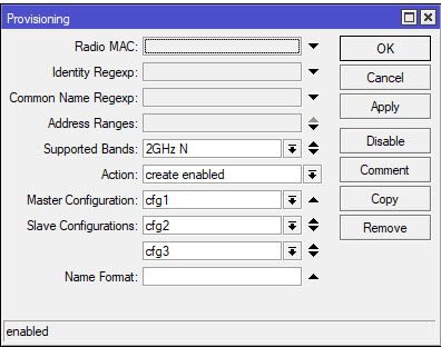

So after getting two SSID’s working:

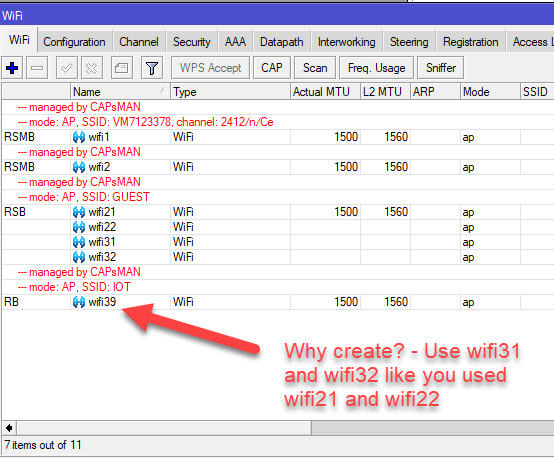

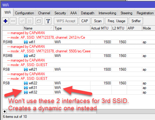

I was very excited to add the third one and added it to the provisioning but instead of assigning this 3rd SSID to the interfaces (wifi31 and wifi32) that I had manually created the cap decided to create a dynamic interface instead with a random numbering choice.
This of course is no good because due to the manual VLAN settings that you have to set up it the capAC doesn’t know anything about this dynamically created interface and therfore the VLAN doesn’t work work.
Can anyone work out why it’s creating a dynamic interface once it gets to the 3rd SSID?

Things I have tried:

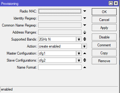

Provisioning: create enabled or create dynamic enabled – same result.
Naming of Interfaces: Instead of wifi1 wifi2 wifi21 wifi22 wifi31 wifi32 – changed to wifi1 wifi2 wifi3 wifi4 wifi5 wifi6 – same result.

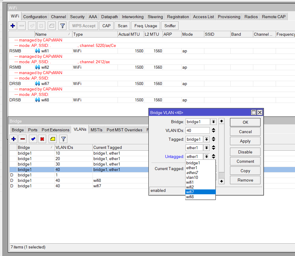

As you demonstrated in the video, CAPsMAN is capable of creating interfaces, so unprovision everything and delete those manually created from the CAPs, lets see what will happen. Also, in provisioning tab set up name format, use %I-wifi and action create enabled.
Anyway, CAPsMAN created interfaces should be available in bridge VLAN configuration:

Since the manually generated interfaces which are then to be configured by CapsMan was showing the problem illustrated earlier in the thread I decided manually create the interfaces that would be created and fully configure them locally just to see that the configuration was possible. What I found was once I got to the 3rd virtual SSID just as with CapsMan i.e.
wifi1
wifi2
wifi21
wifi22
wifi31
it wouldn’t create it because it was assigning a MAC address of one of the physical interfaces without be asking - I deleted this from the dialog and then it created OK - is in conceivable that this what is causing CapsMan to fail?
