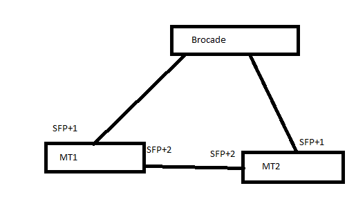

I am using two CRS317-1G-16S+ switches running simple Bridge VLAN filtering. Other than using mgmt access vlan interface I am not using any L3 at the moment.
On both switches ports SFP+1 and SFP+2 are running S-RJ01 SFP modules.
Ports SFP+1 on both are going to Brocade distribution switch. Ports SFP+2 are connected together creating a loop. Brocade configured to be root for RSTP with priority set to 0. RSTP enabled and MT2 put its SFP+2 port in alternate state.

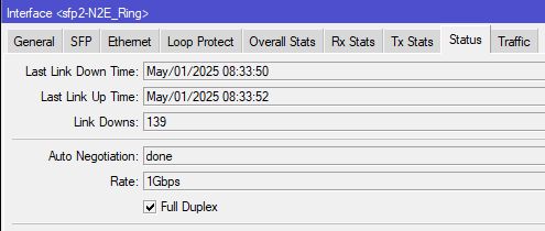

Weird behavior 1: Since yesterday port SFP+2 (which is supposed to be alternate so disabled) flapped 139 times.
Weird behavior 2: After following some suggestions from this forum to try and disable speed negotiation for SFP module I disabled Auto negotiation and forced speed to 1G baseT full. This caused unexpected effect. Both Mikrotiks were running SFP+2 ports as designated. No switch puts port in alternate state.
So my two questions are
  1. Why alternate port is flapping?
  2. Why forcing SFP module to certain speed prevents RSTP election? Am I supposed to enable something else?
