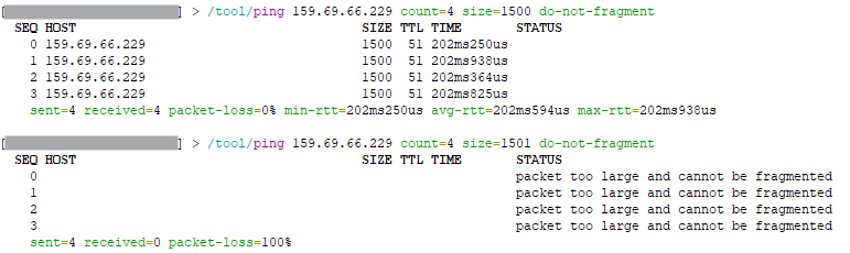

This service has run at MTU 1500 for years. Tonight it stopped working. 1478 is the highest MTU I can go before the ICMP packet is fragmented.
ISP blaming us.
Might be something on the way between your router and the host. From my place, 1500-byte IP packets can still be sent to that host.
That’s just an arbitrary host. I believe this is an issue with our ISP.
