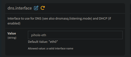

As quickfix it can also be done in GUI
Yes you’re right, thanks for the hint.
