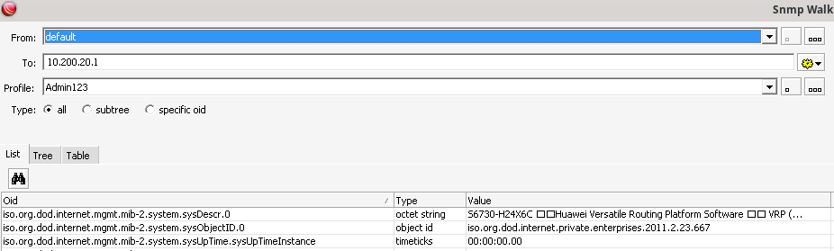

uptime on some devices show 00:00:00:00

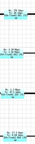

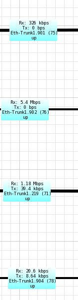

Same issue switch interfaces statistics, not show tx or rx.
7.20.4
7.18

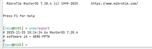

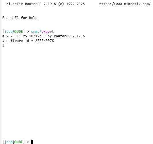

Show your SNMP configuration!
/snmp/export

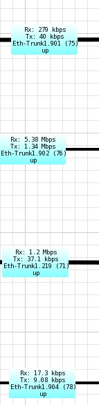

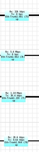

This version is currently in production here: 7.19.6. Any version above 7.20 will cause some hosts to not return uptime data, and some interfaces will only return either tx or rx.

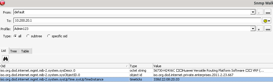

7.19.6, uptime ok.
7.20.5, same host

Same here. We updated our production Dude server to 7.20.8 long term ,and random RX-TX interfaces were showing zero traffic. Reboot the monitored device, and it will start displaying again…… for a while. An SNMP walk using the Dude tool shows any problem counters returning a zero value. Since we don’t have time for this, we rolled back to 7.19.6……. It just works. I did not observe this with a cursory check of the 64 bit interface counters, but then the diff64 function has never worked in all the years I’ve been using the Dude, so I can’t make use of those counters.
