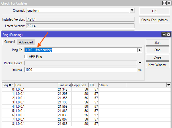

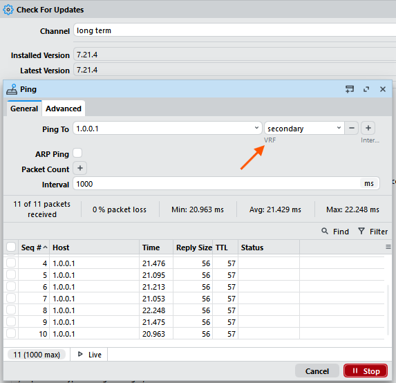

You need to use WinBox 4 to have the UI drop-down controls for VRF and Interface.
If you use WinBox 3, add the %interface@vrf suffix to the address:
