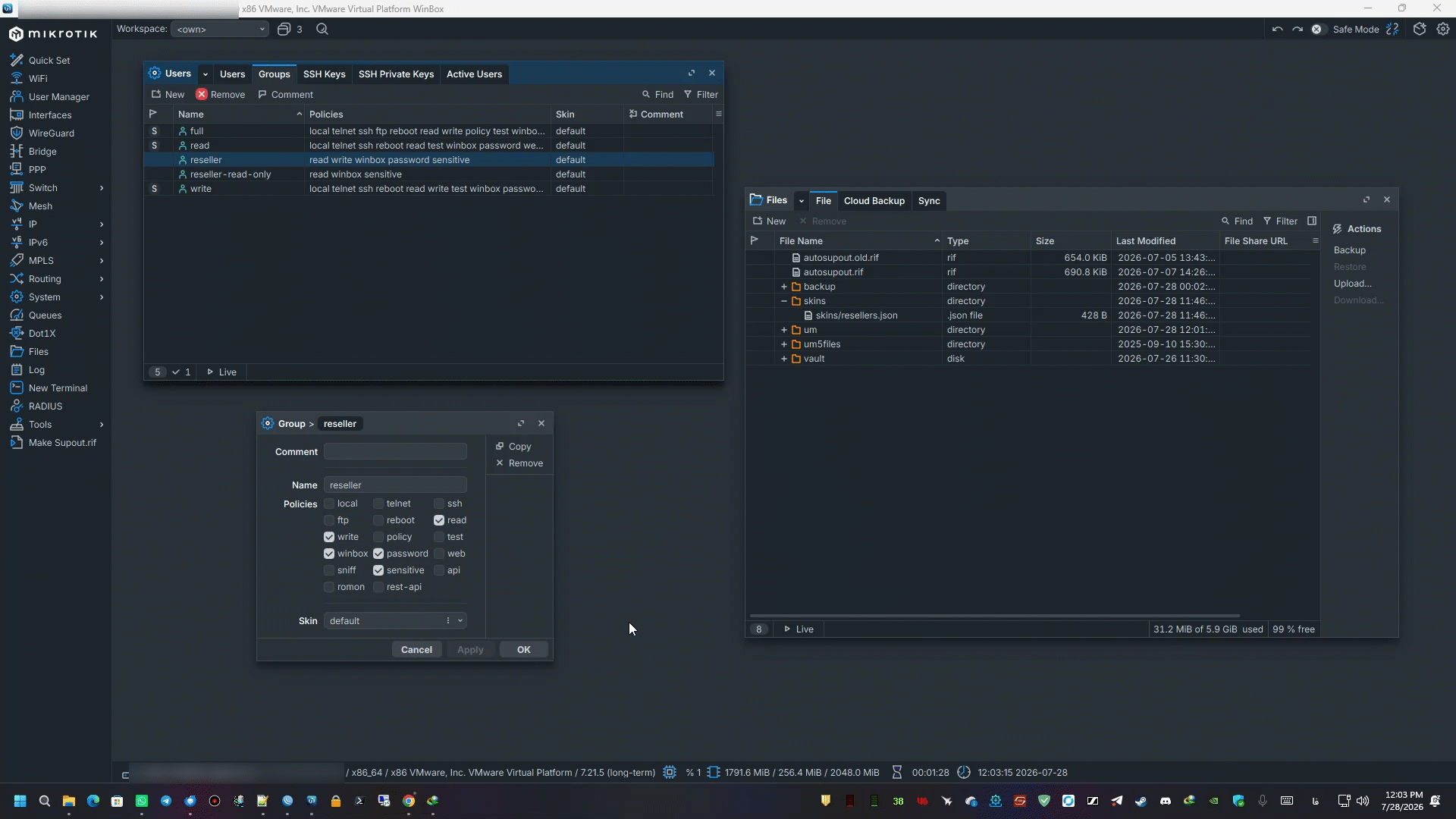

I noticed that it is not possible to create new custom skins in RouterOS 7.21.4, and the issue is still present in 7.21.5 Long-term.
After designing and saving a new skin, it does not appear under Users → Groups → Skin, making it impossible to assign it to a group.
I have verified that:
  • Rebooting the router does not help.
  • Logging out of WinBox/WebFig does not help.
Is anyone else experiencing this issue, or has MikroTik changed how custom skins are handled?
If this is a bug, it would be be great to have it acknowledged and fixed in a future release.
