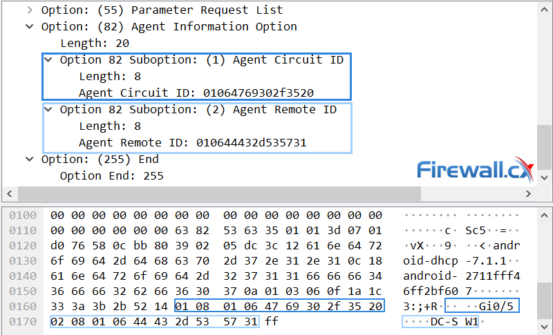

Does your response address the DHCP Option 82 format change? If yes, then your statement is wrong, and the change is a welcomed one. The values of Circuit ID and Remote ID as specified by RFC 3046 are opaque string of bytes, there is no requirement for them to be only ASCII text. In fact, many (non MikroTik) devices encode the port / slot etc... information as raw binary number in Circuit ID for example, and the fact that RouterOS previously presented them as text make matching / viewing difficult. If you use Wireshark, you'll also see that it presents the Agent Circuit ID and Agent Remote ID as hexadecimal in the tree.
Don't believe both claims? See this screenshot in this article:
Notice the 0x01, 0x06 bytes in the values? Now let's see how previous RouterOS versions display them.
For previous versions it was presented as text and it was very usefull to debug/check where this device is physically connected.
