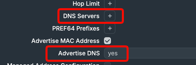

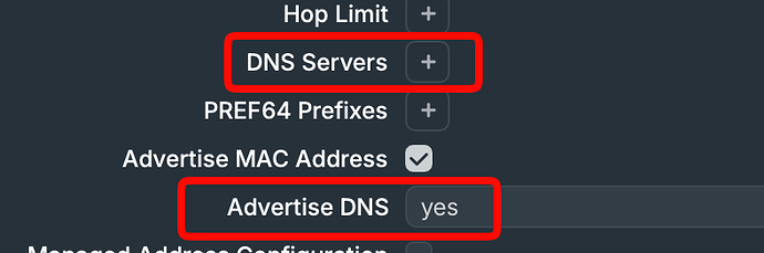

And here is the real reason. Before 7.21, before this change:
This is the default state of the default /ipv6 nd entry. The state when /ipv6 nd export produced no output at all:
That's what everyone who have never tinkered with the default IPv6 ND entry would have!
The upgrade to >= 7.21 will convert that to this:
We can say that this is a problem that the majority of device owners who bought their devices before 7.21 (which was released less than 6 months ago) and have not reset the configuration after 7.21+ will have, and MikroTik has to address that!

I think that problem is the "advertise-dns=yes" in that default entry.
Previously default entry only had Advertise MAC address enabled. Advertise DNS being enabled in default entry is questionable as not all devices are DNS servers in their default settings (on all interfaces to make it worse).
Does setting "advertise-dns=no" on default entry solve the problem of unwanted RA's?
Yes, it does, and it's the default if you reset the configuration in 7.23. If MikroTik in their tests always reset the configuration to default first (and did not test the upgrade path from <= 7.20.x) then they obviously could not see the problem.

If you don't set DNS Servers in this dialog and set Advertise DNS to yes, then the IPv6 entries, if any, that you see under IP -> DNS will be advertised. If there is none there, then the link-local address of the router (similar to self) is advertised.
