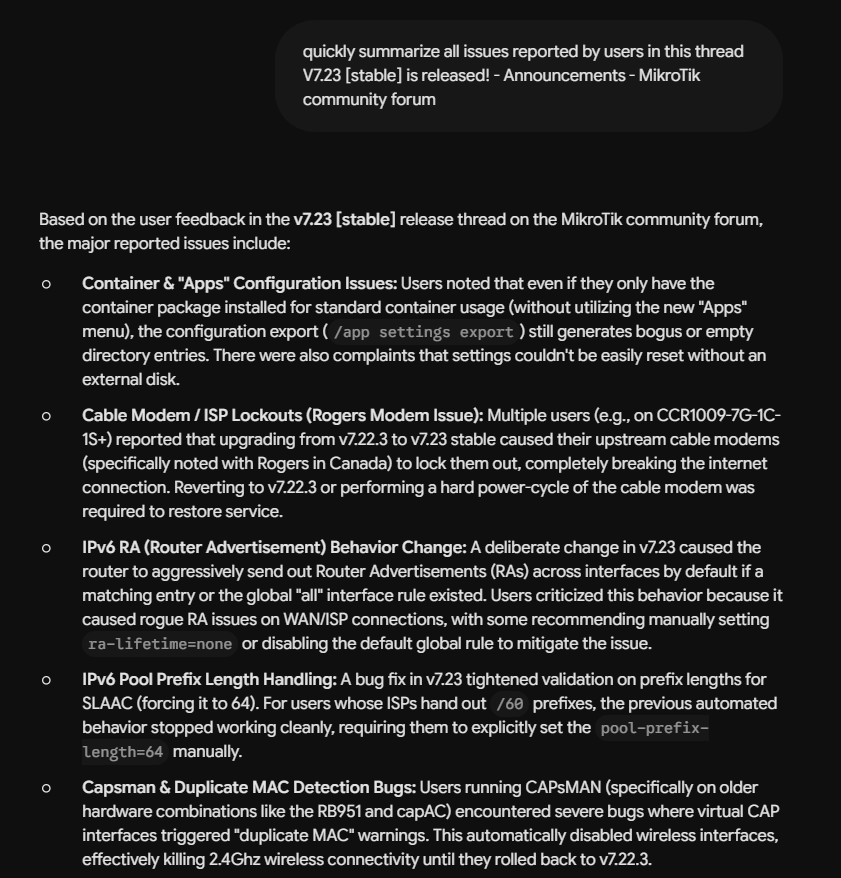

In my case, as I wrote, I did not create any support ticket because I was not affected. But also because I thought that the release thread was monitored by MikroTik. Nowadays, even if the MikroTik programmers don't have enough time to look at every single post, you can still easily use any of the LLM assistants to give you a summary of the problems by given them the forum release thread URL. Here is an example:
https://share.gemini.google/IHjn4LYBR8Cy
As you can see, the RA problem, including the Rogers Modem Issue which is caused by the exact same RA issue, is listed in the summary.
From the items listed, you've implemented fixes for the "App export" problem and the "Duplicate MAC Detection Bugs", if I remember correctly.
Just a side note that might be good to know: if you ask an LLM to search through a thread in Discourse, it will usually only check a few pages in most cases. You have to explicitly require that all pages be read and analyzed, something like this:
Analyze this entire Discourse thread across all pages, not just the first, and summarize the main topic and key issues grouped by theme, including post numbers, official staff responses, proposed workarounds, and overall consensus. Keep it factual and concise, and avoid speculation.
