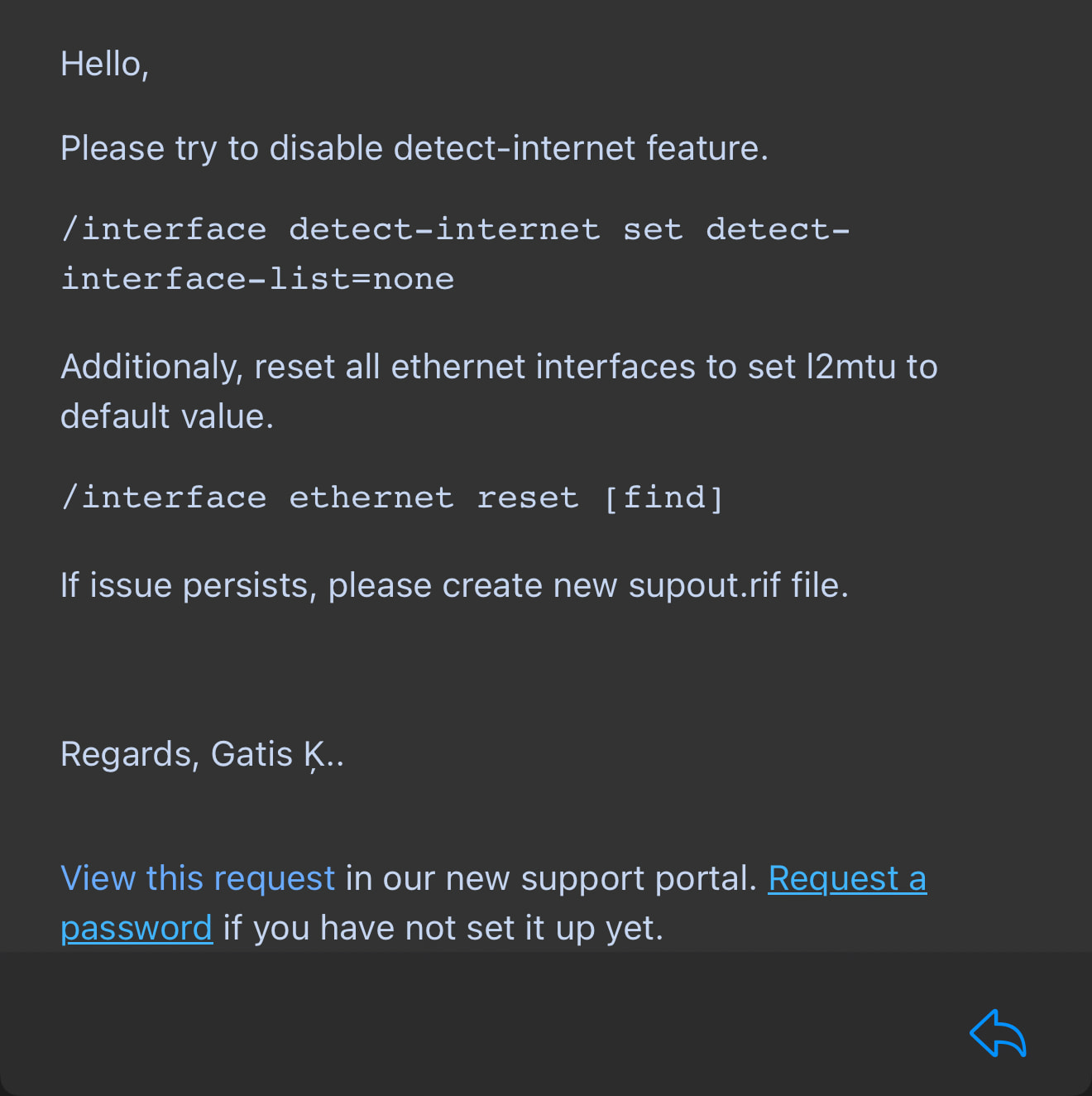

@CGGXANNX
This was Mikrotik’s Support suggestion on the issue I was dealing with. Mind you, I emailed them on July 22nd so I can no longer attempt this since I am on 7.21.5.
I don’t think Mikrotik is aware of the issue, these forums, or they don’t care :frowning:
