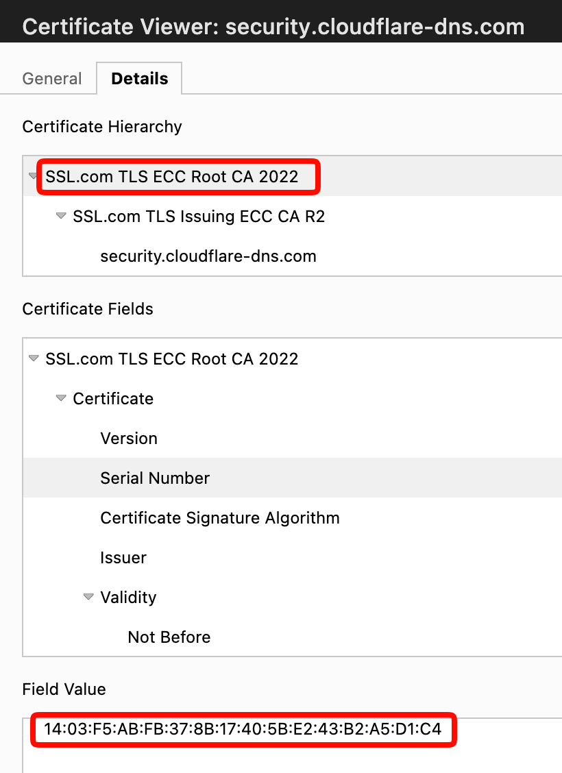

New SSL.com certificate is required.
use-doh-server=no is my stupid mistake (must be use-doh-server=""), sorry.
