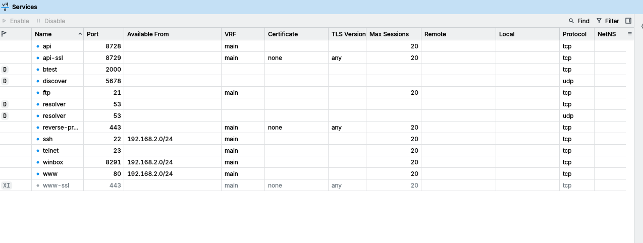

so I updated from 7.21rc2 to 7.25rc4 and now can not acess webfig via browser or conect via ssh / winbox using IP adress ?
can still get in via winbox MAC adress
added the Avaiable From ranges also , and did a full Shutdown / power off and back on

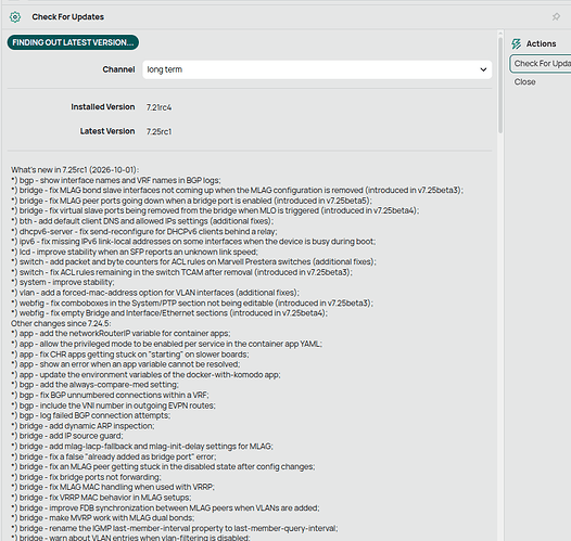

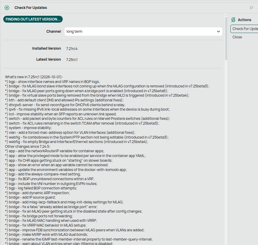

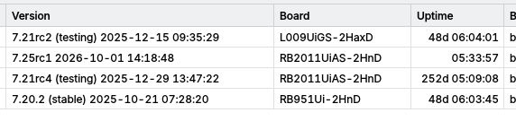

7.21rc4 you call recent? you're mixing up versions. first you said 7.21rc2. your screenshot says 7.21rc4 installed. and upgrade version is 7.25rc1.
Your devices have 48 days of uptime ... which today sets latest reboot to around mid of August of 2026.
But if you look at timestamp shown with version (and those are usually quite aligned with release dates), you can see that those 7.21rcs go back into end of year 2025. I'm not saying that you didn't install those year 2025 RCs in mid of August of 2026, but if you did you had to make some effort (and presumably have some reasons to do so). And that doesn't make them any less "ancient".
Also, RC versions are considered "work in progress" and normally one should not run them after actual version gets released. Unless one knows much better.
yes 48 days ago was last time I did a mass update on routers I had physical acess to
and the last version that they were able to fetch was 7.21rc
today I did check update and went to to 7.25rc4 and then lost ability to get into them
via IP / ssh / webmin it appears the firewall configs got messed with during the update as even after downgrading down to 7.24.5 it would not work , and I had to rebuild configs
7.21cr4 was on another router I hardly touch that would have been done beginning of year

The top screenshot from the post I'm replying to is also very very suspicious. Your device has channel set to long term and yet it's offering you a rc ... I've never seen rc being offered outside testing channel.
Compromised device?
User happily cycling channels and hitting "check for updates" button. :person_shrugging:
