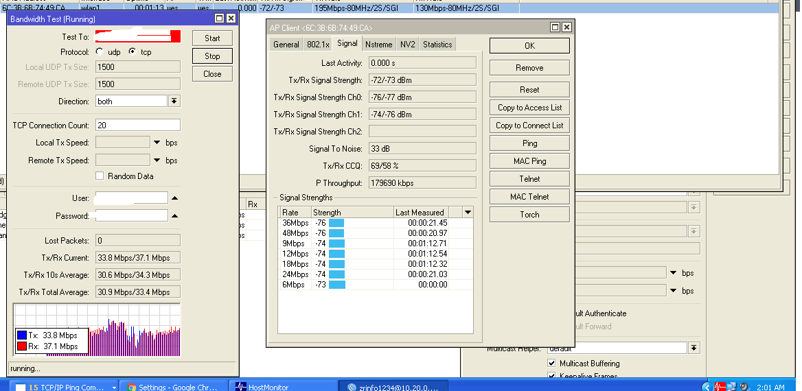

Here, link 38 km … with dynadish 5
wonderful!!!
Is this Link in Swiss? When yes, you are a little bit above 30dbm…
Dynadish has 24 dbI you have to set this as Antenna gain…
And then i believe your connection won´t work anymore …
You are now at 33db SNR -24db = 9db SNR
you are lucky if you get a connection…
Why you need to add 24dbi in antenna gain ? read the wiki carefully …
IMHO if you do not set then Mikrotik do not know that antenna gains output signal with 24dB and therefore total emitted power of Mikrotik + antenna could not meet regulatory limits.
