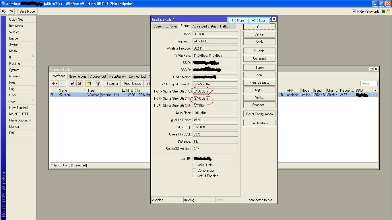

image showing is client device connected with mikrotik ap (R52Hn)
when i place this device in above 500 Meter distance its not connecting
i place this in 50Meter distance it connecting.i found the problem is HT chain .
RB 711-2Hn is a single chain board it have ch0 connecter only.
but in the status ch0 as RX,ch1 as TX
so the RX value is high compare to TX
so its not connecting in long distance
please tell me how to solve this problem

this is not height problem its a HT chain problem
Your RB711 is evidently damaged. Read this topics:
http://forum.mikrotik.com/t/rb-711-mmcx-problems-problems-problems/54110/1
http://forum.mikrotik.com/t/problems-with-new-revision-of-rb711-5hn/51789/1
More specifically, you should have chain0 enabled for both Tx and Rx, and chain1 disabled for both.
