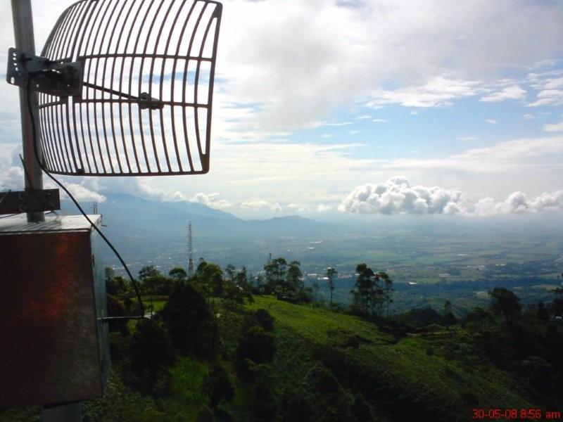

Hi, we wanna share our last longest link with all of you.
1Rb 433—Compex wlm54AGP23—3feet dishes
1Rb 600—1Compex----3Feet.
Both sides 1600 mts over sea.
10 mhz channel space
5600mhz freq.
Nstreme enabled, best fit,
and 18mbps bandwith, 2,3 ms latency.
Cortesia de E.D Enlaces Digitales y comunicaciones. Ibague, Colombia S.A

what’s was the antenna gain? Was it the grid antenna in the photos.
the antennas were, 32db gain dish hyperlink.
