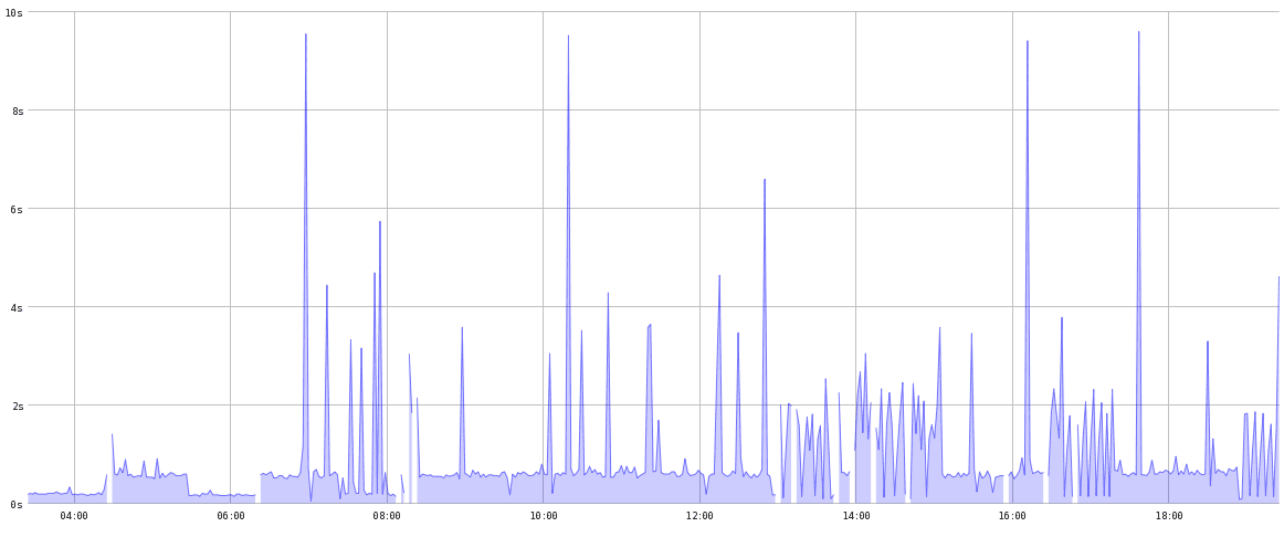

I have similar issues with RB951 and 5.20/2.41. The gaps in the attached ping chart show when the watchdog restarts happened. I have downgraded to 5.19/2.39 and will report back after a while.

I reverted back to 5.19 but then I noticed that my CPU frequency dropped to an incorrect value of 175mhz - this caused similar lock ups like before. After a config reset CPU frequency returned to 300mhz (default) and the device runs without issues on 5.19 since then.
I will not load 5.20 on any 700 or 900 router because I feel the release is too resource intensive.
