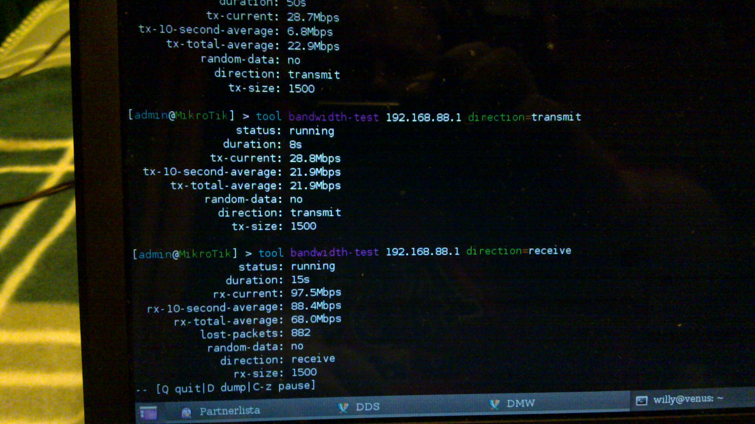

if you make bw test from A device(750G) to C device (433AH) in transmit speed only 28-30Mbit/s (to 433AH ( measured with tool bandwidth-test CIPADDRES direction=transmit on A device) but 97Mbit/s (from 433 AH (direction=receive (any other same) (750G switch chip make backpressure from 1Gbit traffic to 100Mbit traffic but fail)
If you make bw test from A device(750G) to B device (750G second) transmit and receive also 500Mbit/s (the cable good, and device works fine.
If you make bw test from B device(750G) to C device (433AH) transmit and receive also 97Mbit/s (the cable good, and device works fine.
No errors on devices (interface ethernet print stats) no duplex problem no cable problem tested many hours many config many devices.
