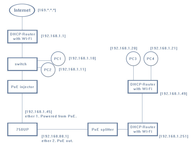

Well, I want to configure 750UP only as switch, but when I’m trying to do something it’s not working as I expected.
So. I my network sheme is like that:
internet → wifi_router1 with DHCP [192.168.1.1] → switch1 → 750up [192.168.88.1] → wifi_router2 [192.168.1.251] → wifi_router3 [192.168.1.49] → switch2
To switch1 connected two PCs
and to switch2 connected another two PCs also.
I’m using three wi-fi routers because, there are long cables between them, and wifi area is expanding.
I think I dont need to change setting at ‘IP->Pool’ and ‘DHCP client’ at all, because I don’t want that 750up work like dchp-router,
I want it only split IP’s.

Can you make a network layout (a plan) from your network please?
Since the ether1 interface is not part of the switch chip you have to create a bridge.
add name=bridge-local mode=rstpEither put all ports in the bridge (1-5)

Wi-fi AP is only on 192.168.1.1
All over wi-fi routers works as repeaters
yeap, bridge do expected result! thank u very much!!
