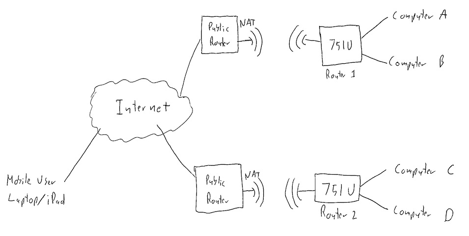

What kind of VPN is a great question. I have been able to setup a PPTP client that connects to my Astaro router at home, but I can use any VPN protocol. Below is what I am trying to solve.
I want to use the 751U device to connect multiple wired devices to a public WiFi that uses NAT (school, hotel, hospital, airport, etc.) I got this much to work great. However, I want to be able to remotely access these wired devices from a mobile device (iPad, laptop, etc). Since I can’t control the public router and setup port forwarding, I figured I would need to setup a VPN server somewhere that is always on. Then both the mobile user as well as these wired devices using public WiFi can be on the same VPN subnet so that they can all talk together.
I drew a diagram of what I have right now. I imagine I need a VPN client on the iPad/laptop as well as VPN client on the 751U device and a VPN server sitting somewhere publicly in the “cloud.”
What I don’t know is which VPN protocol to use so that the mobile laptop/iPad can see computer A, B, C, and D on the same network.
Any ideas?
