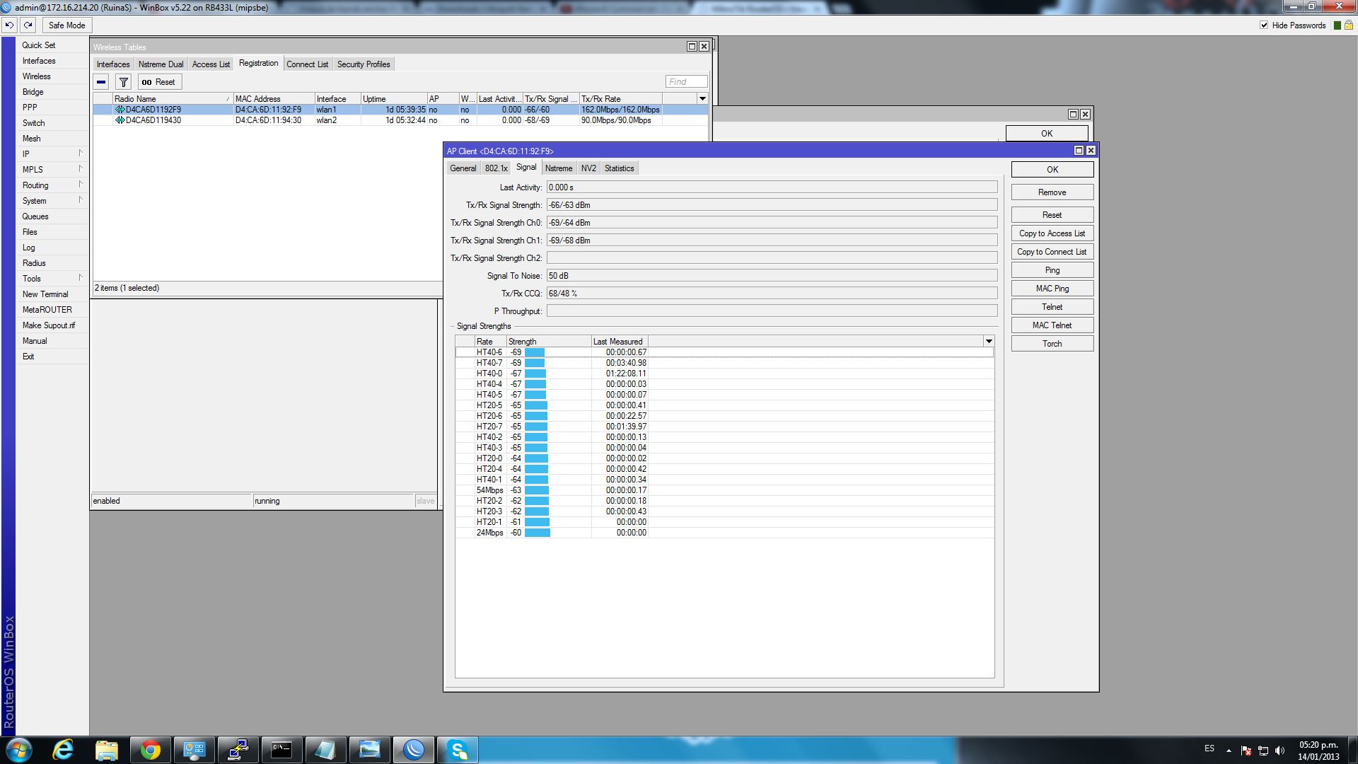

we have a 80 miles link working abouth a year now , but we want to get more throughput, so i need to know if the TX/RX signal strength value of ch0 -69/-64 means that i have a problem on the antenna side or is that difference acceptable

Are we seeing data rates and not throughput? It would be nice to see a bandwidth test from this link?
With only 48% CCQ (Rx side) what do you expect to see?.. :slight_smile:
It’s not easy…Throughput will “suffer” in such a situation.
Need more info but unless I am wrong the numbers don’t appear correct?
80miles = 50db SNR = 48% CCQ = 160Mb throughput?
Could it be 8 miles and antenna (s) misaligned?
