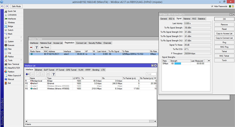

I finally got around to setting this up. rb912uag-2HPnD with Compex WLE900VX minipci-e. Either this card is not “fully” supported or I have more configuring to do. Running btest client from windows 8 laptop through rb912 to CCR1009. It is strange that rx rate is locked at 6Mps.
Only 215Mbps with 80Mhz bandwidth? It’s not a MIMO antenna I see, right?

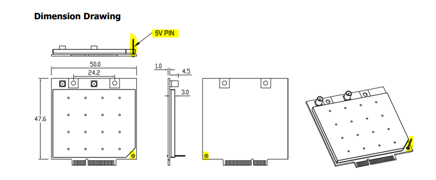

Did you connect the 5V pin on the Card?
:confused:
“5V (compulsory and external)”
“Customers have to connect a 5V power supply to the pin on WLE600V5-23”]
We are talking about WLE900VX - there isn’t such PIN there.
Update: new drivers for wlan driver on laptop, now connects a little faster. Maybe next release of routeros will allow for changing HT80 tx power and maybe VHT tab in winbox?
