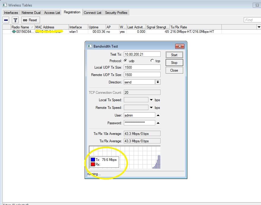

OK I think I may have found a fix! :laughing:
Since I know it is a distance issue, I tried to manually set the ACK. I set it to 372 (roughly 32.7 miles) to give myself a little overhead, and the data rates are now 216.0Mbps-HT / 216.0Mbps-HT
and here’s my new speedtests!
Manual ACK
http://i1218.photobucket.com/albums/dd403/wispwest/ManualACK.jpg
Send Speed
http://i1218.photobucket.com/albums/dd403/wispwest/AfterManual-ACKSend.jpg
Receive Speed
http://i1218.photobucket.com/albums/dd403/wispwest/AfterManual-ACKReceive.jpg
