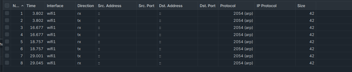

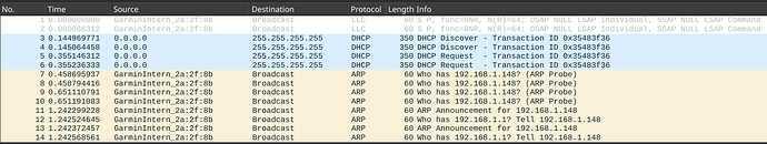

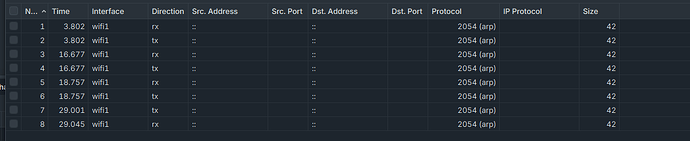

Maybe run a packet sniffer so you can see what that 5MB of data is (to a file and then you can check with Wireshark)
The steering and all roaming related stuff was already kicked from the 2.4GHz config in the latest config post - without success :frowning:

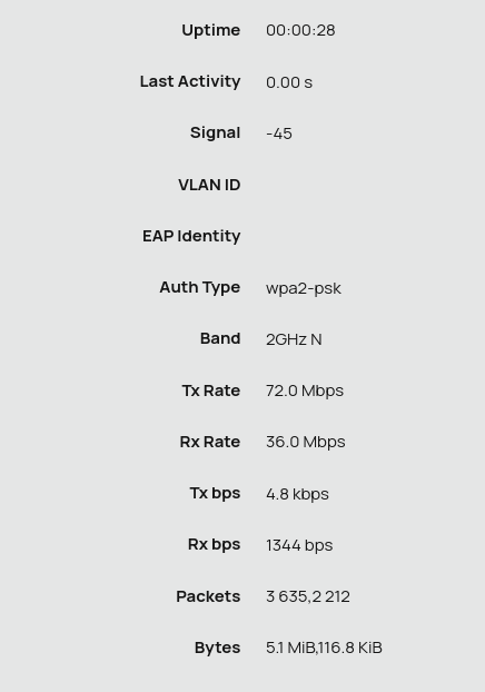

The device gets and IP and transfers some data, I can see it when syncing a Spotify list - the first song usually gets transfered.

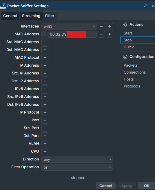

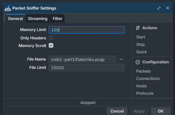

Can you give me some additional hints how to record the transfered packages to examine with Wireshark afterwards?
Thank you for your support effort, really appreciated!
You can use the Packet sniffer like this, for example.
Just set the filename, interface and mac address.
We’d be interested in the last few packets that are transferred if theres anything unusual.

Sorry it took me so long to answer again. I did a package sniff with applied MAC Filter of the Garmin and could dump the log here, because interpretation is beyond my knowledge. Or is there anything that should be removed from the logs before posting it?
Well, the sniffing logs are very thin. Those are the only entries when selecting the Mac Filter and only recording the WiFi interfaces.
Quick question:
Did you set “MAC-Address” or “Src Mac Address”?
It seems we can only see traffic FROM the Garmin
We should usually see traffic in both directions :smiley:

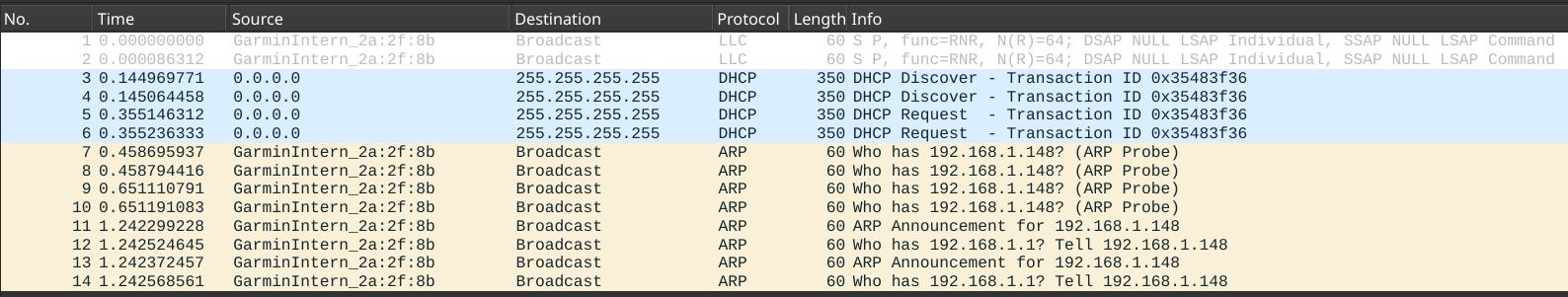

@Juke I think the way forward is to capture raw Wireless traffic on your laptop and contact Mikrotik support / send bug report. Make sure to include supout of your AP as well as MAC address of you Garmin (so it can be identified in the logs).
Happy to look at the wireless sniff if you to share it here as well, but FYI it discloses the list of wireless devices in your LAN.
Also makes sense to contact Garmin support as well. If other devices work reliably it can very well be something amiss with device’s firmware.
